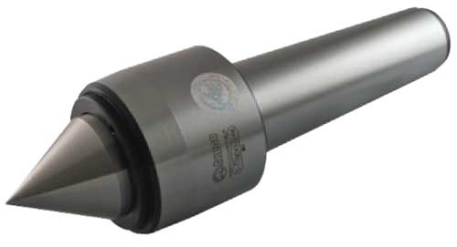

I did - I have like 4 of these in MT4 and I have also one brand new MT4 for sale.
Some bearings are not that hard to replace - the main problem is the "basket" bearing. Since this is MT2 I am not sure whatever it is the same as MT4.
The thrust bearing and the end bearing on MT4 are standard.
ducdon
I did open it up. The bearing and shaft at the end opposite the center are really small and secured with a very small snap ring. I really didn't want to tap or press on it. It would be very easy to damage. So I flushed it really well with light oil (3 in 1) and re lubed everything. I think it's going to be OK?

Awesome! I have an MT3 Live Center with a brinelled bearing. I really should take it apart one of these days and replace the bearing.
