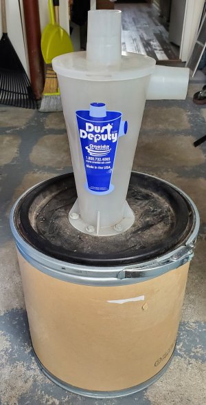

I have a small dust deputy on a small 10 gallon fiber drum. Normally it sits on a cart with my small rectangular shop vac and makes a compact unit that is easy to move from machine to machine.
I plan to design a new all in one unit based on the low profile dust deputy/lid below. This will allow me to use it with the surface grinder and coolant.
I'm planning a vertical tube with an wider filter chamber that's split in the middle to mount the filter in a 3d printed flexion style frame. I'll violently shake the frame to clean the filter after each use, the dust cake will dislodge and fall into the bucket below.

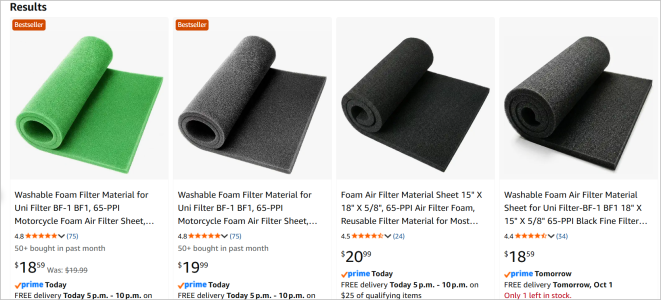

(Foam) filter medium in sheet form is pretty easy to get. This is Amazon screen grab but I'm sure cheaper in quantity. You have to make sure its intended for filtering meaning it has permeability, usually its defined numerically or at least should be. Closed cell foam looks similar but is essentially joined bubbles = nil permeability.
