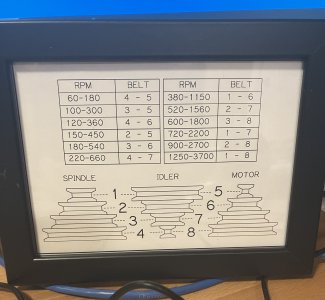

While I was at it, did a chart for my RF30 mill. I have a 2hp 220/3 motor and VFD, with the VFD programmed for a range of 30 to 90 Hz operating frequency to the motor. I may increase the range as I get more familiar with the machine, for now I feel it’s a reasonable spread that won’t tax the motor capabilities.
Much easier to read than the gimpy little label that was stuck on the side of the belt cover.
