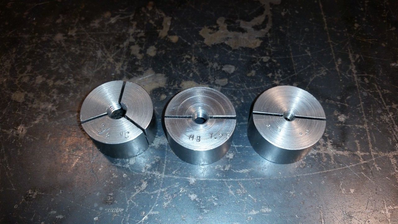

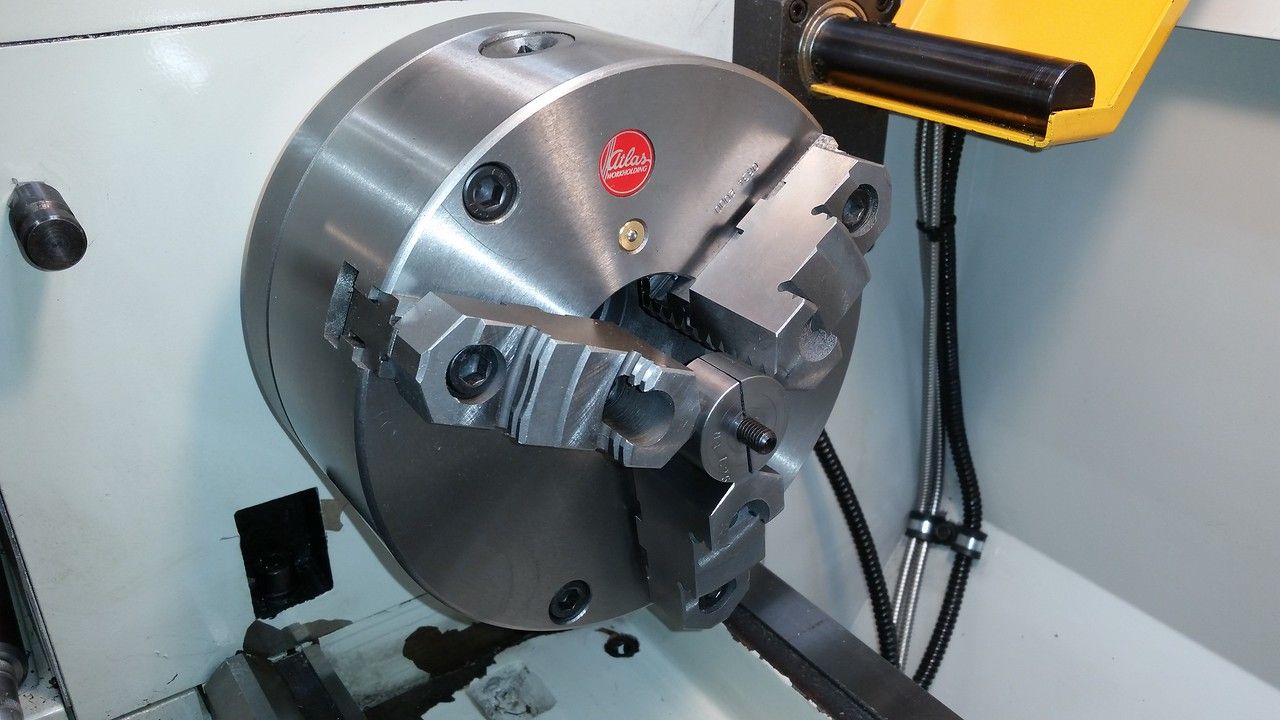

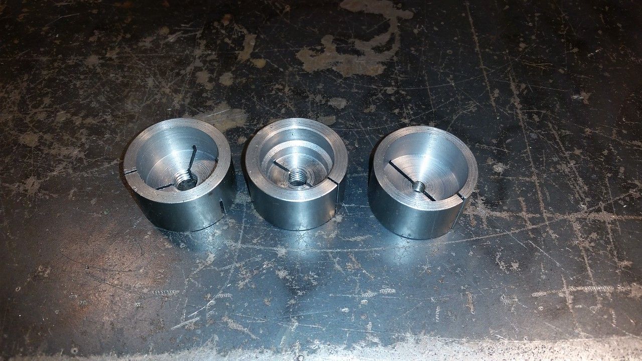

OK, I'm on the right track now. I made a simple version of the holder @John Conroy showed. Just used some 5/16" aluminum tapped 8-32 and then slit from each end with the hacksaw. If I tighten the 3-jaw as hard as I can, the screws usually stayed put.
Just need to repeat the same thing with the 10-32 screws.
