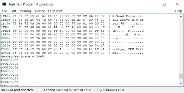

To send the code I still need to do some work on this application written in Lazarus Free Pascal so it will work on PCs, MACs and Linux systems.

By about 1AM yesterday I had results. The Lazarus Free Pascal program downloaded 0x2045 bytes (8,261).
And connecting to the programmer with a serial port program I did a dump and sure enough the last part of what was programmed appears to match.
Then today I added the READ command with the size currently fixed at what I programmed. Later I'll add dialog to enter the actual amount to read.
ERASE command is in place and just working on VERIFY now.

I did end up programming the flash memory 3x to diagnose the issues. So handy to have built up the flash memory programmer. Final software that goes into it will be a more extended monitor and the bios for the CP/M system.
