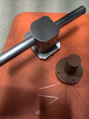

Most of the stuff I am removing rust from just needs a shot of Fluid Film. Spray it on, let it sit for a few hours, and then scrub with a green scour pad, my wife's tooth brush, whatever works. Then another wipe with more Fluid Film to help prevent further rust.
Top item used to look like the bottom item. Obviously not as rusty as your items and more work involved but the clean-up is simple
