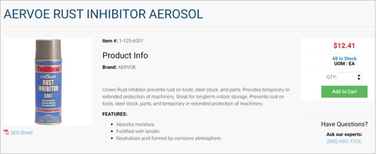

There are so many products &, crazy prices - I'm starting to wonder about snake oil markup. Lets say I want to assemble typical outdoor use machinery like lawnmower, snow blower etc. that sees wet & dry cycles (corrosion recipe). Would spraying this stuff on fasteners & parts before/after assembly help keep the rust minimized? This was cheapest can at KBC just as example.
