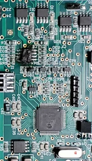

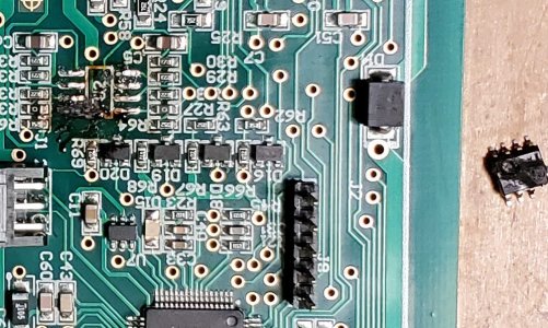

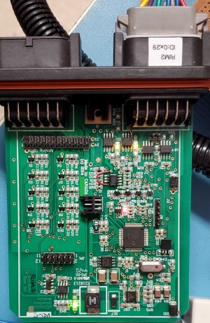

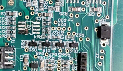

In this particular case I'm the designer of the boards that were returned to me instead of tossed into scrap. My client asked if I wanted them for spare parts otherwise they were going to be recycled as scrap. The world is so used to trashing electronics that doesn't work they don't even think about potential repair or repurpose.
In this case the reason the 22 units were returned is because they accidentally wired 24V into a 0-10V output pin. By the time they'd figured it out a bunch were trash.

Nice repair @jcdammeyer

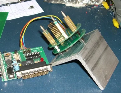

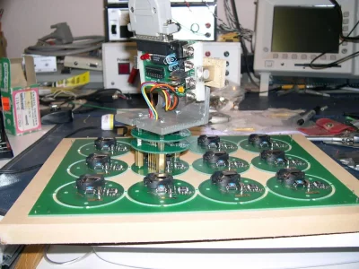

Here's a photo of a simple project I did many years ago. Only needed to be programmed once but with a unique code for each. The programming assembly was on an XYZ gantry system I built but with 20 TPI 1/4" threaded rod lead screws and cheap PA stepper motors it was way too slow to automatically program them. I ended up just inserting the programmer and pressing the spring pins against the board.
The brass hex alignment pins were done on my Gingery Lathe.
