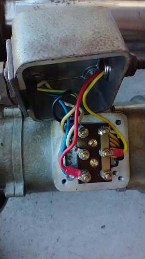

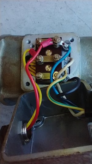

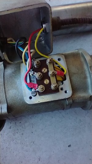

Finally felt well enough to get back into overdue projects, and had the time and inclination to rewire the motor for the Mill spindle in order to prepare for adapting it to the lathe as a grinding spindle.
There is no documentation, no wiring diagram or anything else to go by but luckily my brain still works and I managed to rewire the 3 phase motor correctly to go from 380 to 220v. Standard stuff except for the motor brake element which I didn't mess with.
I don't know swiss / german power standards or plugs but this had a funky plug with 3 round pins and a round recess for the ground. I also can't make sense of the amperage calculation for 3 phase power, but I think it is incorrect because of the electric brake part. I also think the CH is the motor HP of 1/3.
Anyway, I wired it to one of my VFDs and gave it a quick spin up. Aside from the carrier frequency needing adjustment the motor and more importantly the spindle spins smoothly and silently. We are going to be in business soon.
Before:
After:
