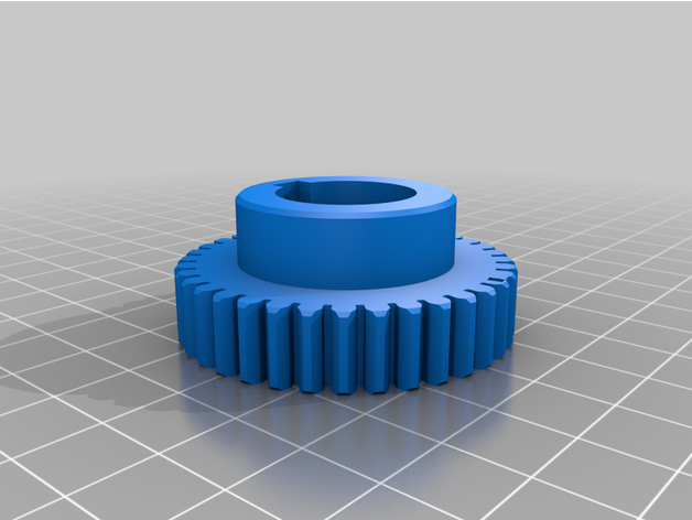

If you have access to a 3d printer you can do a search for lathe gear on thingaverse and print your own.
You maybe able to modify an existing 52 tooth gear to get the correct size and bore. Just an example
I've had success printing change gears before, but as this gear transmits power directly to the spindle, I think a 3D printed gear would detonate pretty quick lol. For how much work it was to get the thing out, I'll put the proper thing in there.
