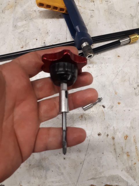

Tool Ratcheting Tap Handle
Tool
Aw, CT strikes again. I don't see it on line. It wasn't cheap. I think I was surprised when I did find the second one for home. I have two so I'm good, but if I was desperate, I would try Amazon Germany. There are also tool stores that ship to NA . Handy if you want Stahwille wrenches.

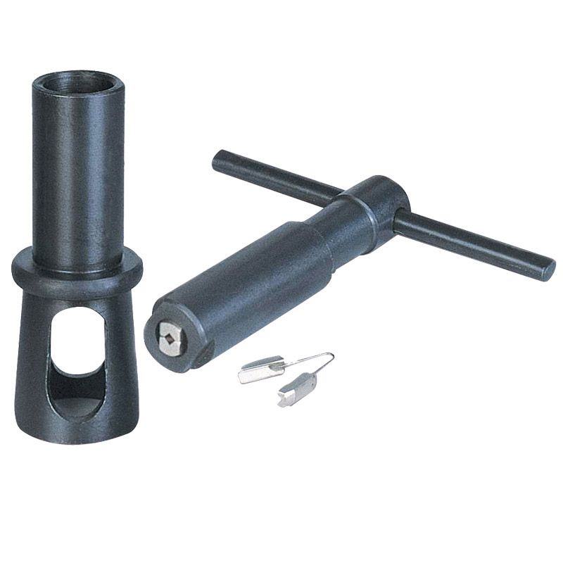

I also discovered these fixed tap handles from mitutoyo at ITM Instruments canada. I ordered two. Shipping is $17.
https://www.itm.com/search?search=tap+wrench+mitutoyo
Does anyone have something like this? Care to comment?
I have several sizes. They work with both drills and taps. Mine have replaceable bushings too. I almost never use them except when faced with unusual circumstances. They don't work that well but are sometimes better than nothing.

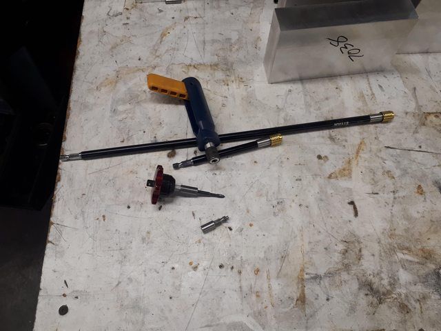

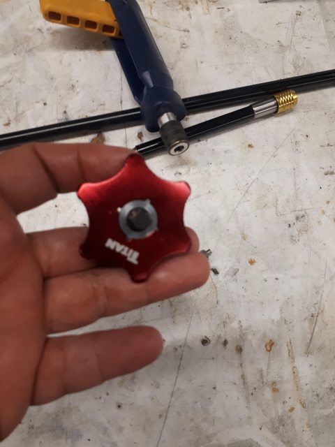

That's a good price considering Mitutoyo name. It looks to be the 'always locked' collet style. As opposed to the ones that have a forward/reverse/lock ratchet like att pic.

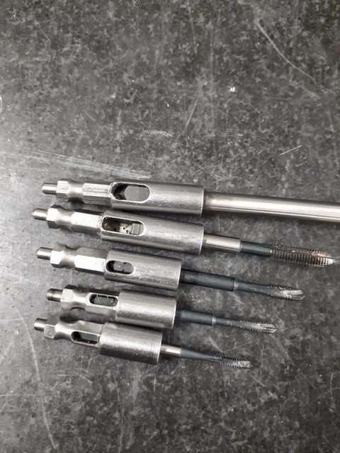

But if you want to use it in a mill or drill press, there are other models like Walton. For that kind of application I keep reverting to my homebrew arbors because I can make the body OD slimmer than the typical tap handles, provide more self alignment contact area to the tap body & the overall length is shorter. I can either grip it in collet or chuck & tap under power or leave it just a smidge loose & use the tommy bar for more control
