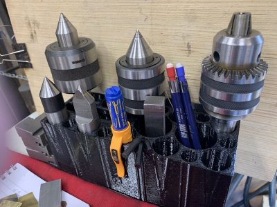

I have vertical posts supporting a mezzanine which I start to attach tooling to using 3d printed MT brackets
Not perfect but within reach of machines
The thing I like about this approach is that you can space/place them anywhere you want to. Are the pass-through holes tapered or straight? I thought there would be products in the market like these but I haven't found any yet (don't the overseas folks make copies of everything?) as I would expect that market to have the cheapest prices and and most viable for me since I don't have a 3D printer. Did you experiment with fill rate and if so, what % made them sufficiently rigid?
The pass through holes are not tapered from what I can tell. In fact, the ones I printed were all MT4 printed at a reduction of 6% as the dead centers would pass right through. As for infill pattern/density, I printed about 4 different versions. Version 1 I broke with my hands, version 2 separated (bad infill pattern choice), but I finally wound up with a good combo (40% w/ rectilinear I believe).
I like a lot of the other solutions posted -- still looking for a good chuck storage plan myself.
Most nights that I'm in the shop, if I'll be there for 1.5 hours, then I'll through another mount to print whilst I do other work. I printed them all in PETG.
