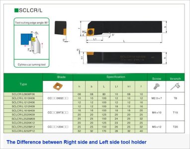

Sometimes the classic 4-slot tool blocks have some interesting dimensions that may or may not be indicative of your setup capability with modern tool posts. I'm not sure if it has to do with the era, maybe 1/2" was the approximate max HSS blank whereas now a 5/8" is considered a common 'small' tool shank for insert carbides. To add confusion, sometimes when you see 5/8 or 0.625 (which is 15.875mm) it can also mean they are trying to North-Americanize the dimension & the slot can accommodate 16mm (metric) tool shanks like example attachment. 16mm = 0.630" ... see what I mean?
My experience has been the toolholder blocks can be milled but its not exactly fun. They can be made from pretty tough stuff & heat treated, but I've also heard of softer variations like Dabbler says. It seems to depend on origin. The offshore grade toolholder shanks themselves can be something like ordinary 4140 steel but they can also vary. I've successfully cut & milled them although not for this purpose. A high quality N-Am shank can be very tough stuff, so even if its free, milling it down isn't worth the headache IMO when you can buy an offshore shank for under $10.
I have a 14x40 lathe & 15-16mm is the biggest tool shank I can run based on the tool holder block. Although I don't do a lot of heavy load carving its rigid enough for my purposes. I tend to favor CCMT & DCMT inserts. Probably if I had to choose one I'd get DCMT. Anyways take your time to consider the variables & pros/cons because it sets up a chain reaction of other tooling. Or ask any questions if this isn't clear.
