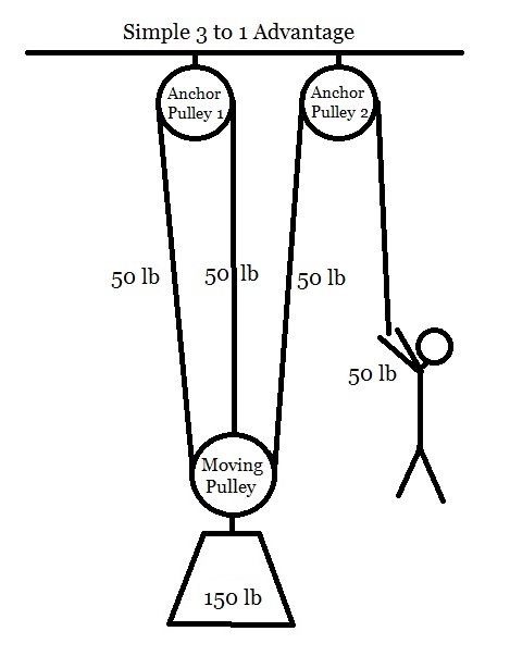

and yes 3 to 1 pully systems work great you can pull trees down with small car too if you get high enough ratio

what’s a 3 to 1 pulley system? isn’t a single block just 1 to 1?
Ye just going threw the block once would be a 1:1 but if you add more pulleys you can change the ratios up too 15 ish before it becomes pointless larger cranes after 250t you can start to see how they use pulley ratios to make things move
Gotcha, I just meant a single block, not to increase pulling power, but to just yank stuff onto the deck or change direction of pull
