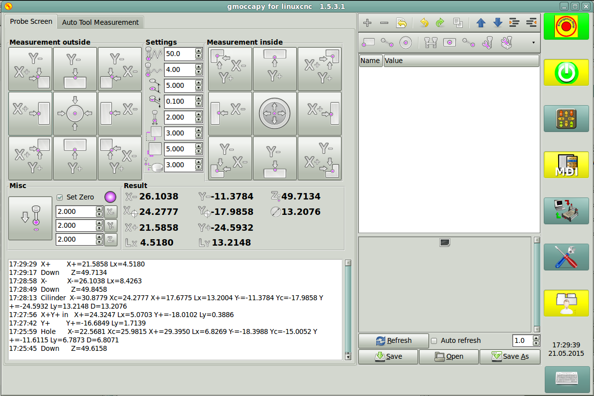

Then I did some research and found the probe screen for the AXIS interface. Seemed nice. Fairly long thread about it on one of the EMC forums. So I ordered the versaPR probe which arrived on Wednesday. Good quality. I ordered and received two extra probes in case I break them.

Here's the start of it (all 52 pages)
You can see how the suggested changes were incorporated over the length of the thread from 2015.
This is the original
and this is the one that I'm using since I've installed LinuxCNC 2.8 on both the PC and on the Pi4

The tutorial for the Probe Screen is pretty good. You use git to bring in the zip. Unpack it and put the folders into the appropriate places. There is some editing of the ini and hal files but nothing serious. It's targeted at an automatic tool changer so I found I had to undo some of the changes it suggested with respect to handling Tx M6 G43 commands.
For example in my .ini file I identified what was done with respect to the probe like this:
# begin Touch Probe EMBED_TAB_NAME=PSNG EMBED_TAB_COMMAND=gladevcp -c probe -x {XID} -u psng/python -H psng/psng.hal psng/psng.glade # end Touch Probe # begin Touch Probe [PROBE_SCREEN] # Offset from [AXIS_Z]MAX_LIMIT for performing moves during various probe # screen movements. This must be a negative number. Z_SAFE_TRAVEL_OFFSET = -0.1 [TOOLSENSOR] # Absolute coordinates of the toolsetter pad X = 1.0 Y = 1.0 # Absolute Z start search coordinates Z = 2.0 # Maximum search distance and direction (sign) MAXPROBE = -2.0 # Speed of movements during working in Probe Screen RAPID_SPEED = 60 # Diameter of toolsetter pad TS_DIAMETER = 1.0 # The speed of the reverse rotation of the spindle when measuring the tool diameter REV_ROTATION_SPEED = 300 [CHANGE_POSITION] # Absolute coordinates of the tool change point TOOL_CHANGE_POSITION = 0.5 1 -1 TOOL_CHANGE_QUILL_UP = 1 X = 0.5 Y = 1 Z = -1 # end Touch Probe
Notice the begin/end comments. That's how I kept track of what was there before and what I added for the probe screen. Notice that I also had:
[EMCIO] EMCIO = io CYCLE_TIME = 0.100 TOOL_TABLE = tool.tbl TOOL_CHANGE_POSITION = 0.5 1 -1 TOOL_CHANGE_QUILL_UP = 1
A second set of Tool Change position variables. This caused a double movement of the Z axis for every M6. Commenting one of them out fixed that.

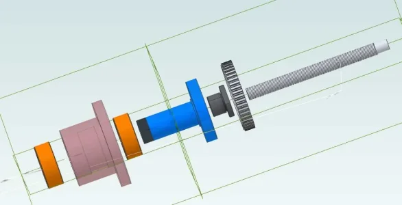

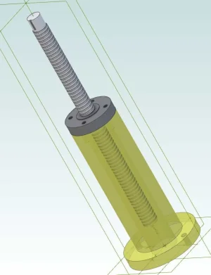

I'm glad I did it that way as often the knee has to be moved very close to the lowest limit for items held in the vise or rotary table and a 3/4" chuck in the quill. And I still use the hand operated quill from time to time. I don't like the bevel gears so eventually I'll rebuild the knee to have the motor turn a pulley that turns the ball nut while the screw is held fixed as opposed to the current approach which turns the screw.
I couldn't find a used 2HP 3 phase and new plus cost of VFD moved me to the Bergerda AC Servo. Don't regret it although I will still make new toothed belt pulleys. The one I made for the motor also has a slightly wobble I think so at 3000 RPM it's a bit rough. But that's due to the machinist, not the motor...
