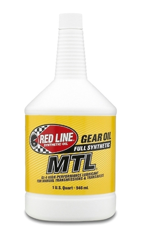

The research agrees with the journey I took on this a few years back.... The trick is therein to find a straight GL4. I didn't have any luck at CDN Tire and the other retail haunts.
Here is one product that claims to be safe on brass gears. The company website lists several Calagary retailers.
MTL® 75W80 GL-4 Gear Oil
Popular for BMW (before 1993), Honda and Acura, Ford Focus, late-model Mini Cooper, Dodge & Jeep NV 1500, 3500, and 5600www.redlineoil.com

I'm using this https://www.redlineoil.com/mtl-75w80-gl-4-gear-oil not the MotoMaster stuff.
Thanks Craig, unsure who carries Red Line MTL 75W80 GL 4 Gear Oil in MJ although Peavey Mart might.
I got it at a PartSource store. That link I provided has a suppliers list, it will tell you if there are any suppliers near you.
