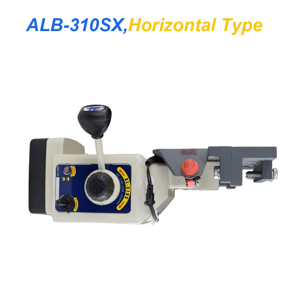

So, I ordered a Powerfeed from Vevor, unfortunately the style I got is not one that will work for me. I am looking for the Powerfeed that instead of hanging off the side of the mill table. Similar to the one in the picture below. Anyone know where in Canada I can get this from?s-l1600.webp

That style is hard to find and when you do it will not be cheap 🙁
I managed to adapt the 'Bridgeport style' one to the left side of the table on my RF-30 clone. I'll look for the thread.

Crap, I just sen it back. I think I am going to have adapt mine like you did yours.
i have the style you are looking for on my rf30, david is right, they are not easy to find and they are not cheap, i paid well over 300$ for the one i have, kinda wished i had just modified one, at least if it breaks the replacement is much cheaper
