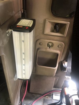

It’s more of a cabinet, that’s bolted to the floor overtop 1” of insulation. First cobra and first Samlex were bolted to the side of it, second Samlex was sitting loose on top of a toolbox that isn’t bolted down. I can add in some rubber feet for the next transition
I’m starting to learn just how much stuff can break just from hammering on poor roads. I guess I shouldn’t say I get a year out of a power inverter, instead she was good for 150,000 kilometres

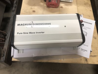

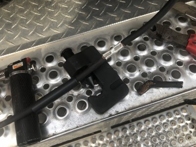

Picked up a cheap-ish Dewalt once we was back across the border. Goofy ends on the cables we farmer fixed that
But now the new one won’t turn on :(
I’m giving up for tonight
I got the screen on the new inverter to flicker blue but that’s it, so more junk from China is my guess.

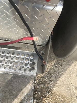

Still no bueno. I’m not understanding this
Sept- Truck running, high idle, wouldn’t run the microwave
Sept- Truck running, low idle, printer plugged in (not printing), laptop wouldn’t power up
Oct 4- First phone call to tech support, 45 minutes on hold, got cut short because I had a meeting, their initial thought was the printer was a power hog (?)

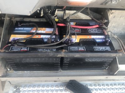

Oct 28- 4 new batteries, alternator was new around May 2022, found 3 bad battery cables, fixed 2, had to leave the 3rd
Still will not run the microwave. Says it’s 1100 watt input, 700 watt output (truck running)
Owners manual says I should be running 2 gauge wire, I have 4 gauge, it’s approximately 6 feet from the batteries to the inverter
Positive for the inverter is on one battery, ground is on an opposite battery
Within 10 seconds of running the microwave, the voltmeter on the dash drops dramatically (truck running), and the error message E06 flashes, connected load is too high
Other than another call to tech support, which I’ll do next week, I’m stumped

Sounds odd to connect to two batteries unless they are in parallel. Most inverters are 12V not 24V. Not sure what you have there.
The cable size called for is bigger than you are using, but either way, a 2 or 4 cable suggests 12V not 24. Typically lower voltages require bigger cable. I know that isn't intuitive. Just trust me on that one.
What does it call for and what are you feeding it?

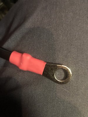

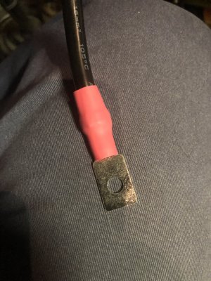

Regardless, back to the cable for a second. Big cables need GREAT connections. A poor or small connection will cut the cables capacity out from under it. Cable Clamps don't generally cut it. Needs to be a regular battery clamp bolted onto the battery terminal. Not always easy to do for secondary loads. But you can get battery clamps that will connect two high current loads at once. That's probably what you need here.
The draw too high suggests a short circuit or a load not designed for an inverter - eg a 120V device on a 240v circuit.
Also possible the load doesn't like a square wave power source or something like that.
Do you have a decent multimeter? If you have a good one, you can measure the voltage drop across one of the cables to calculate actual input and output current and voltage. Don't try to use the meter in current mode unless you have a current loop for it - you will fry it.
At any rate, my very first check after looking at wires and connections would be to do voltage and current checks on everything.
