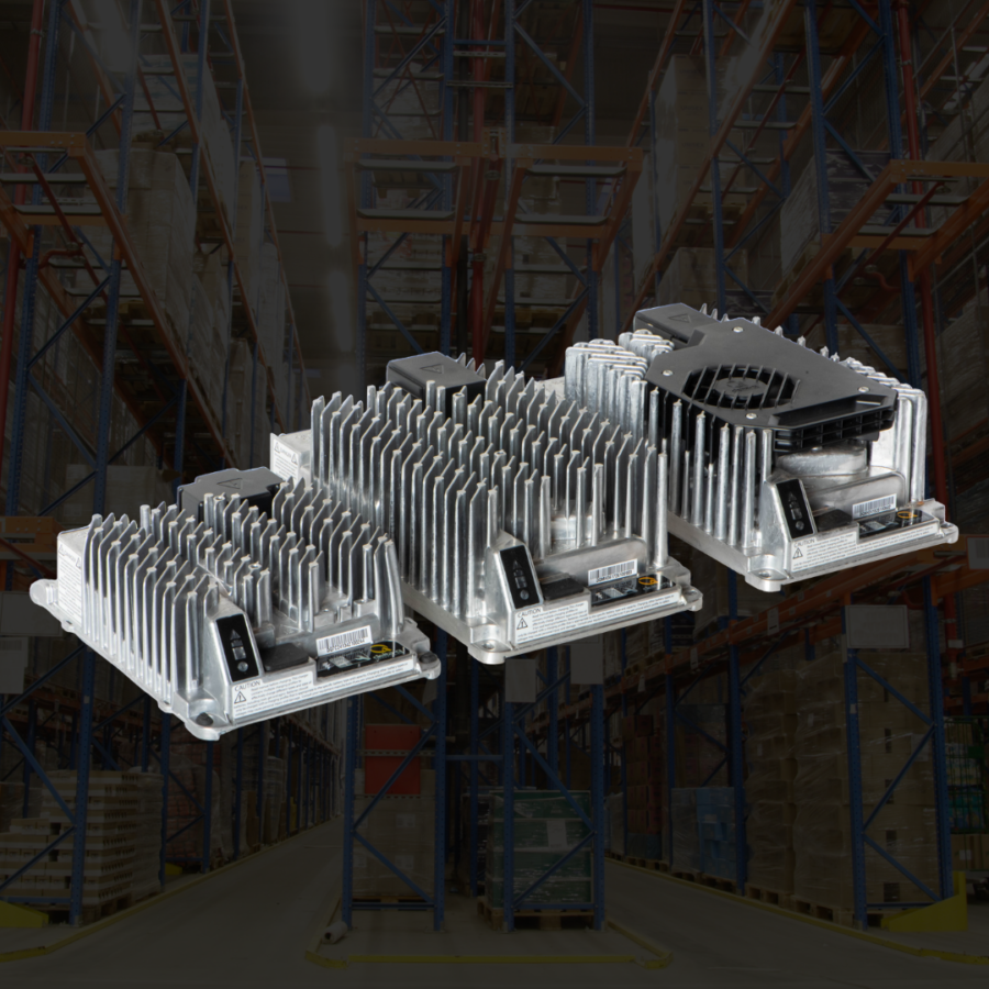

Oh. Forgot to mention that there are 3 DeltaQ 650W chargers that if all connected into a 20A circuit then a generator with a 20A 115VAC circuit will easily charge the batteries and supply the load. It's a constant on system so when AC is connected the DeltaQ chargers supply both the load and charge the batteries. The Valence BMS tells my control system what to set the charger voltage at so the batteries get the correct charging current.

The system originally started with ELCON battery chargers controlled via J1939 CAN messaging to charge Lead Acid Batteries. The batteries were recharged with an ONAN diesel genset. There was also solar panel charging. The generator was started and stopped automatically. This photo shows the big batteries and the starting battery. Under the 'table' is a power supply that was supposed to be for my CNC system to fake out solar cells. Solar controller beside that. On the 'table', two 1500W Elcon chargers, relays etc and on the far right my controller module.
When the system was changed to Lithium batteries and more reliable DeltaQ chargers some major changes had to happen.
There's a used charger on ebay for $250, new ones run over $1000.

Now here's the problem with Lead Acid and why the change to Lithium.
1. Discharge below 50% State Of Charge (SOC) and reduce the life big time so the generator had to start at SOC 50%.
2. Lead Acid batteries take forever to reach 100% SOC and draw very little current during that time so the diesel generator would run for extra hours with almost no load. They would carbon up on their exhaust system
Lithium Batteries with their Battery Management System (BMS) can be discharged to 5% SOC without changing the number of discharge/charge cycles and can take full current (70A) up to 99% SOC. Only about 30 minutes at a final conditioning 10A is required to finish charging them.
Down side of Lithium batteries is temperature. Below -20C or so the BMS won't even enable the contactor and below zero or so charging is not allowed. So those systems, when it's that cold require the generator or shore power to start producing power to heat the batteries. Once they reach 5C the chargers are enabled and the batteries brought up to 100% and the application load is enabled. Once they are charged the generator is switched off and the battery controller runs the heat blankets to keep the batteries warm enough for for load discharge.
