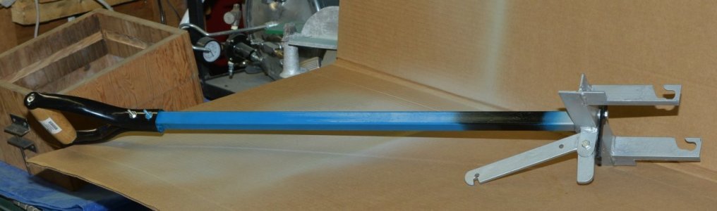

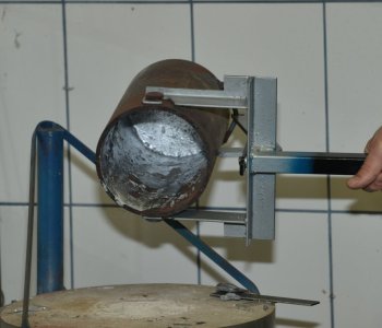

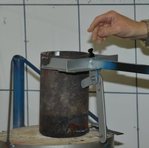

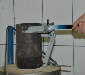

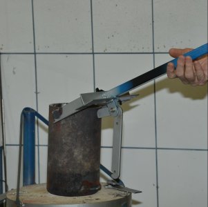

Now that my spoon for scraping dross has been finished I can get back to the foundry. I made a pipe crucible and lifter for it 5 years ago. Here's the model.
Works really well for a one person pour of a 12 lb melt.
