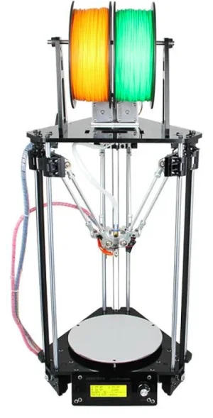

Long story short. Wanted a Delta printer. Bought expensive, for the time, Delta printer. What a Piece of S. Slop in the universals. Plastic filament drive unable to push filament through bowden tubes. Too much play in the linear bearings so twist one of the slides and the hot end moves several mm. And the 8 bit Arduino software just was inadequate.
So I splurged on a Replicape and Touch screen for a BeagleBone Black running LinuxCNC and Octoprint and found that one of the stepper motor drivers wasn't working. Even changing drivers around in the software still had problems. This was about 6 years ago. Gave up.
It's been collecting dust. It's in the way. To make it fit the Replicape I had to replace all the connectors. Well today I put the original connectors back on. Once I correctly put the X and Z limit switches into the proper places it homed. Yahoo. It's alive.
Now why am I doing this? Well it was collecting dust. The BeagleBone due to a failed Replicape and no support because the designer has moved onto other things was a total loss. So I thought now that I know more than 6 years ago perhaps I'd pick up a few more linear bearings to stabilize the motion. I've already replaced the extruder drives with all metal units. I have a whole bunch of different types of extruder nozzle assemblies.
So it's time to do something with the POS. I figure if I can make it mechanically sound then maybe one of the more advanced 32 bit controllers would handle it better.

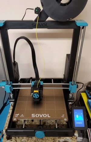

Haven't used the POS Delta since February what with all the computer crash and rebuild issues. Needed to print a small adapter for the kitchen faucet handle ... again two years after the first ... (PLA really the wrong material) so still used the 2006 cartesian 3D printer system since the G-Code was still on the Raspberry Pi2. Just start it up and select via OctoPi web interface the part and print. Kitchen tap handle works again.
OK. Why bring this up? The original printer is like my band saw. Turn it on. Use it. Turn it off. Well today my Father's day gift to myself arrived. 300x300 build surface. Still direct drive instead of the long tube like on the Delta POS. Very stiff. Very quiet. Had a demo by my friend JoeMac. That sold me.
Have no idea where I'm going to put this. Might end up sitting in the box for a few weeks.

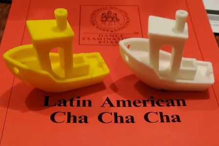

@Susquatch This picture is mostly for you. The Yellow one is done with the new printer. The white one with the old. Not really visible in the photo but the roughness of the hull from the general vibrations and shaking. I'll admit I wasn't using the same parameters since the G-Code for the new printer came on the SD card. So I'd have to do some detailed investigation to determine what parameters were used. But both prints took 1.5 hours so can't have been that far off. Anyway, the new printer makes much nicer smoother prints.
I am in awe. When I take photos for posts, I usually have the top of my freezer, or a chunk of used white paper, as a backdrop. “Latin American Cha Cha Cha”? We applaud excellence, no matter it’s form.
