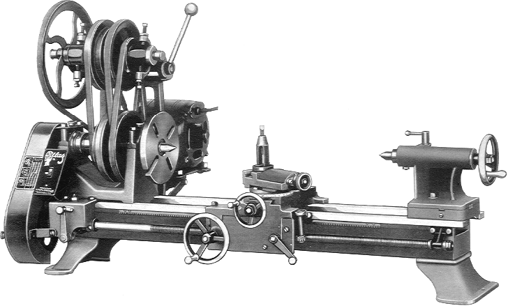

You said you have an Atlas 9 inch, right? This one?
Atlas 10-inch lathes from the first to last. Includes details of the British copies by Acorntools, Sphere and halifax
www.lathes.co.uk
I know Atlas made milling attachments for the later 6 and 10 inch lathes but I don't know about these models.
I think the 9 inch models were only made in the early 1930's? If so, you've got a really old, very light duty machine. Probably with a non-trivial amount of wear over the years. Asking it to do milling work is a lot. It seems unlikely that you're going to be happy with the result.
