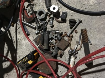

IMG_0214.JPG This advise has led me to this solution and the following refinements, the eureka came when i spilled this tub of bits. IMG_0217.JPGThis pic is of the back, a straight accident just waiting to ruin the day. I had this piece kicking around for years , no idea where its from when or why i have it but thats just a scrappers life 😵
