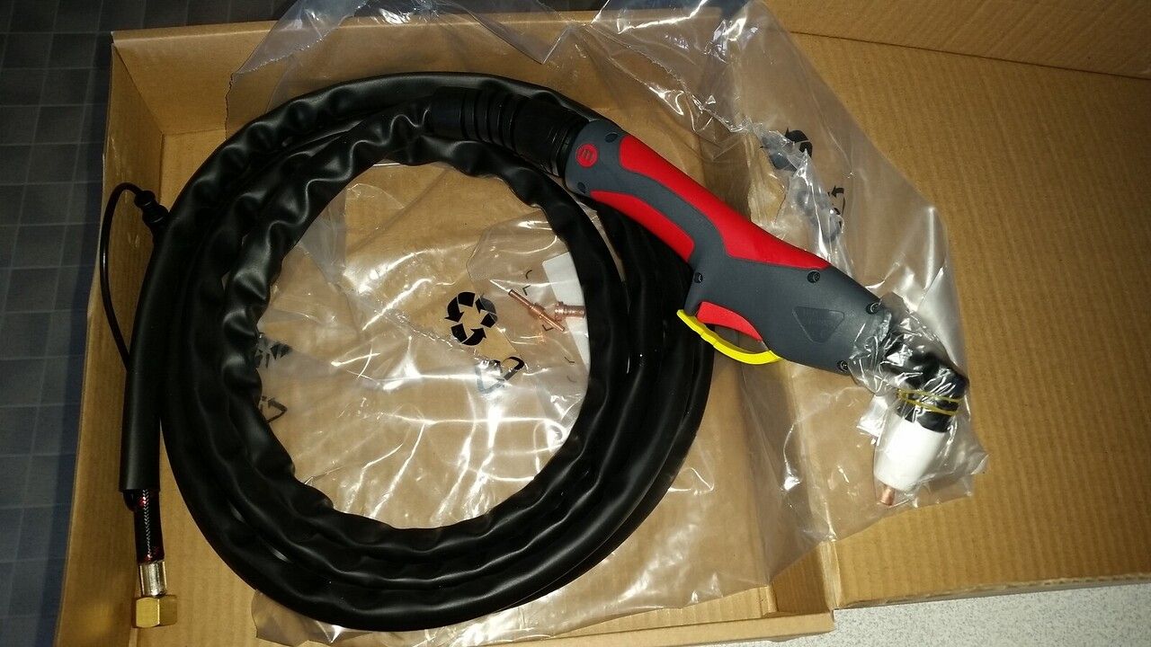

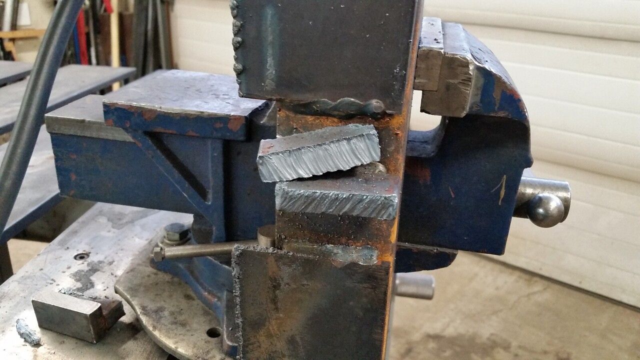

I got the new torch today. This thing is so nice I can't believe it was less than $60. The volume of air through the hose is huge compared to the old one even after my temporary repair so was able to turn the regulator back down to the recommended 70 PSI. My machine has a 7 pin connector for the torch switch and all the new ones have a 2 pin connector as does the new torch. I just cut the 2 pin connector off the new torch and soldered the leads onto the connector from the old torch. The hose is covered with a very soft pliable rubber sleeve, the old torch whip was stiff as a board plus the new one is a foot longer. I made a dozen passes through a piece of 3/8" X 3" CRS and it cuts very nicely now. If you are looking for an updated torch for your cheap Cut50 style machine I recommend this one.
This amount of cutting would have destroyed the drag tip and the rest of the consumables on the old torch but they still look like new on the new one.

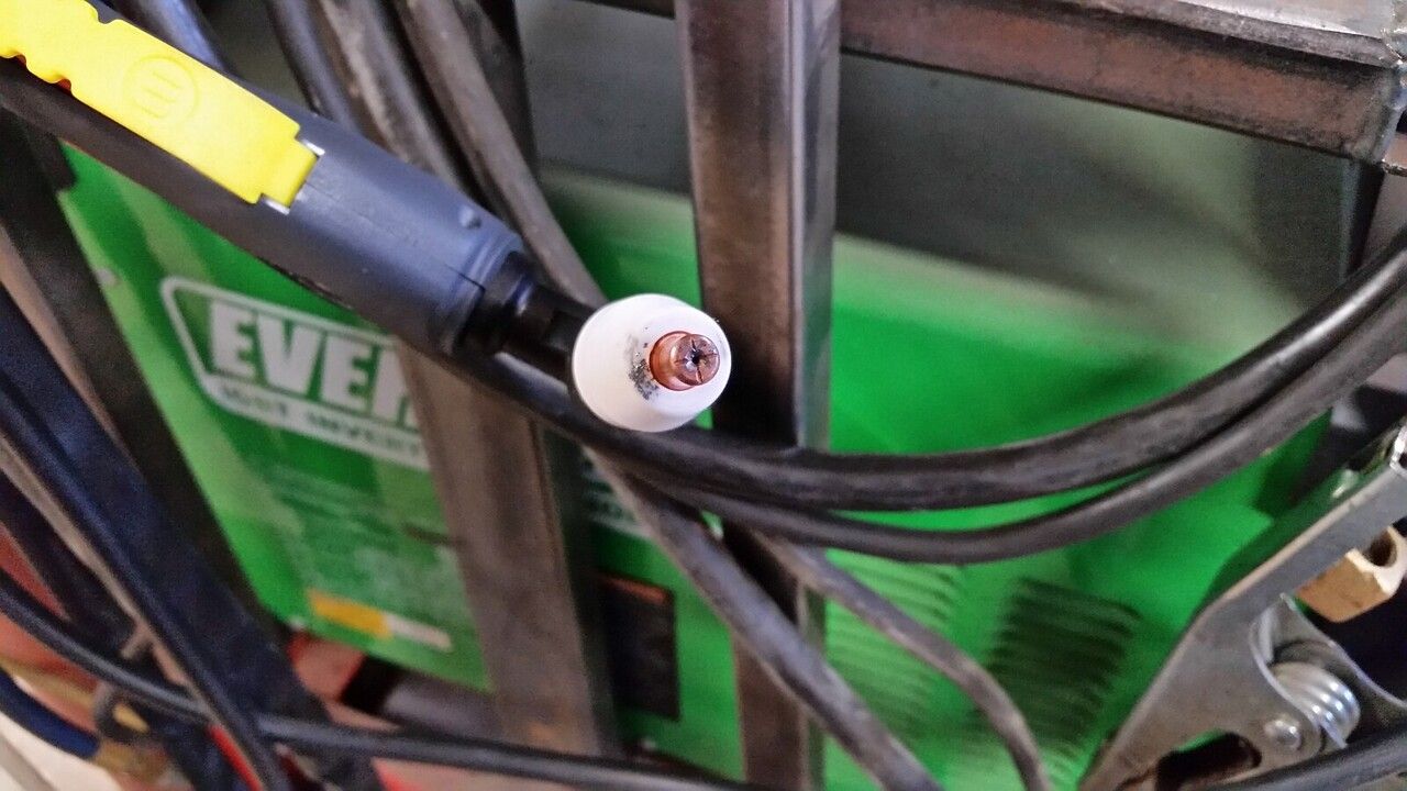

I have a cheap Chinese plasma cutter that has never performed well and has now quit working completely. I'm pretty sure the torch is at fault and I have ordered a replacement but I'm thinking of buying a better quality machine and scrapping this one. I'd appreciate hearing about other people's experience with their machine and opinions about what to buy.
