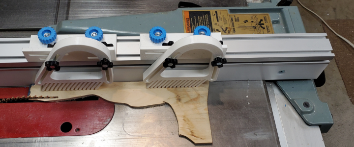

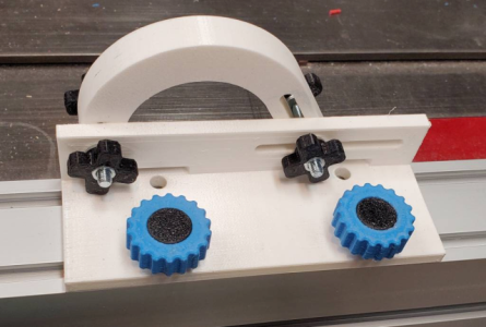

Truth be told often 3D printing is chosen because it's easy but the solution can be found in other ways. For example. @DavidR8 and I purchased a replacement extruded fence for our Delta Table Saws. The curved extrusion has always been a pain to clamp feather boards etc.
So of course as soon as it was installed the 3D printer was put to work.
Now it's true. With some 3/4" plywood, wing nuts and bolts the same thing could have been done. And as it was I had to go to Lowes to get some 5x0.8x40mm bolts since the design I found online used 5.5mm slots and the black knobs were meant for 5mm nuts.
The bracket I designed myself to fit on the new fence and it uses 1/4" bolts. The first knobs I used were from the Compressor monitor project but they were a bit large. So I scaled that down and reprinted in blue.
The recess is so I can use shorter bolts and also I'll print a cap that gets glued in to retain the nut.

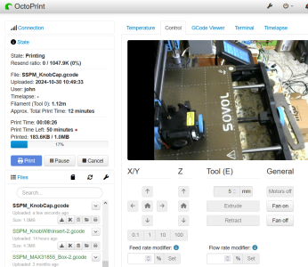

Same here.
Raspberry Pi3, Camera, OctoPi Software talk via USB to the SOVOL printer.
Watch what is going on from upstairs.
And keep churning out parts I guess.

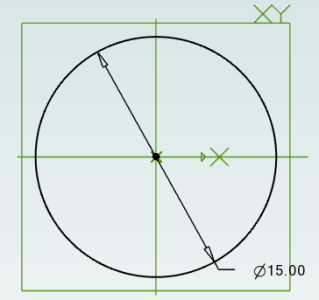

For example. The covers over the nuts on the project I just finished.
I started with a 15mm diameter circle which is called sketch<1>.

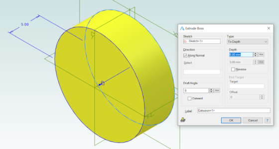

Next I extruded a boss. It's like plastic extrusion pushing melted plastic through a die. In this case for 5mm.

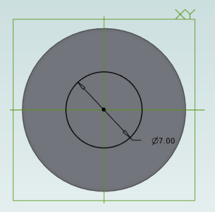

Now I have something equivalent to a 15mm diameter dowel cut to a length of 5mm. To make sure there's a bit of clearance for the 1/4" bolt to extend past the nut I need to put a hole in the middle.
So I place a circle on the surface. 7mm diameter for that 6.35mm (1/4") bolt that might come through a bit. That's sketch2.

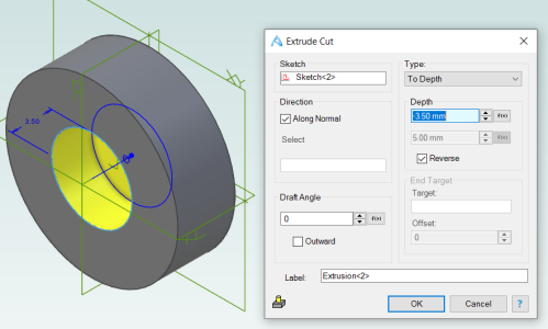

Instead of extruding now I'm going to cut (like drill a hole) for a depth of 3.5mm
Now 3D printed holes never have absolute 90 degree shoulders so I need to round off the edge a bit so it will go all the way down into the hole. That's called a fillet. Like smearing body filler along a 90 degree corner or in this case taking a file to the sharp edge and rounding it a tad.
Save the file. Export it as an STL file for the 3D printing format. Print it hole side up so the bottom also has the textured finish of the build plate.
Drop it into the hole. Either some Krazy Glue or Epoxy and the nut under it will remain firmly in place.
And yes, I could have made the knobs out of wood and embedded the nut in a round hole with epoxy and just cut up a piece of dowel as I described above.

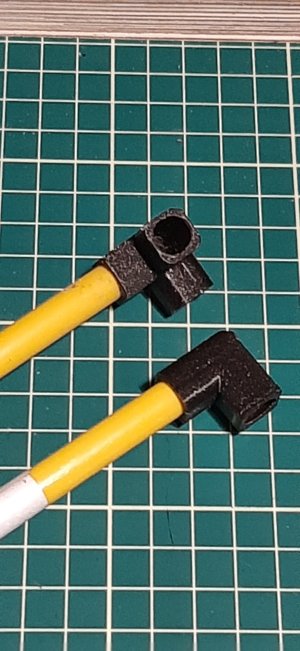

After visiting Slow-poke and seeing all the stuff he printed with his, I was amazed at what could be done with a plastic filament printer. The following week, I decided to look on kijiji for a use one. I found a Prusa mini and I am super happy I bought it. It motivated me to learn cad which I have always wanted to do but did have the opportunity to try it out. I have never done anything other than writing email on a computer. It was a bit of a learning curve but not that bad with lots of Youtube tutorials. I am always mesmerized looking at the little toy printer. In the beginning I would watch it print for quite a while, just couldn't believe what it could do. Yesterday I printed some tube connectors. I must of fondle the part for half an hour in admiration and wondering how did it succeed making such a nice part.20241031_193838.jpg
