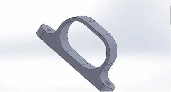

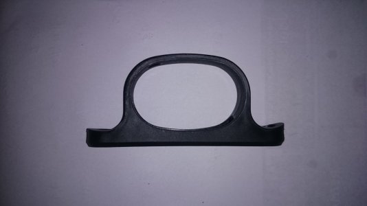

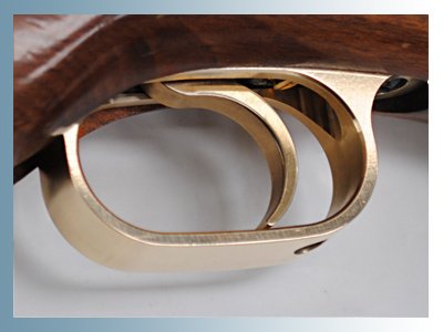

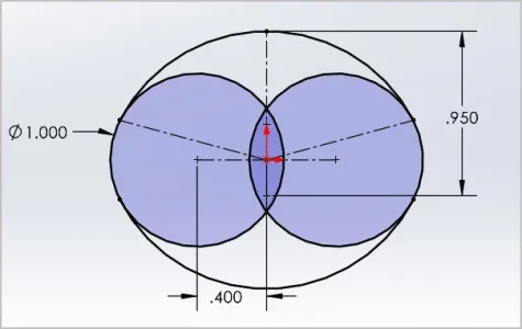

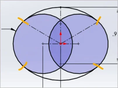

Oval, ellipse or something else?

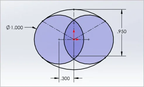

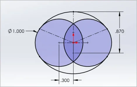

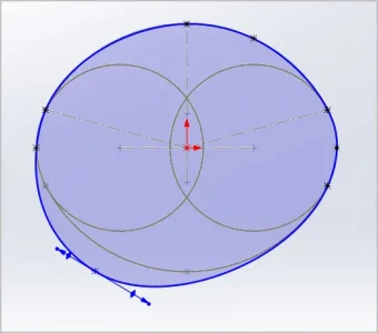

Its probably just photo perspective but using this as example, you could also modify the 2-circle + 2-arc method to create a different shape by altering the relative diameters of horizontal circles but still connect them with a tangent arcs top & bottom. This would give the shape a more wedged aspect ratio in one orientation if that was desireable.

I am in the camp of two different sized modified Circles like the last one and like @thestelster made. I prefer a trigger gaurd with a little asymmetry to it to accomodate a gloved hand. The Remington factory 700 trigger gaurd is a good one in my view.
