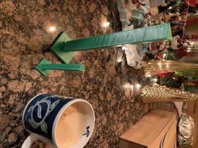

Next model I want to build is 2” legs 18” high. That will be to scale. It rotates too on the long axis.

Ok Toblerone fans...
You might be onto a commercial item there. Just in time for the holidays - a Toblerone holder! LOL.
Well I broke down and bought a parker spool gun and the welding obelisk continues. Welding aluminium is really tricky.
