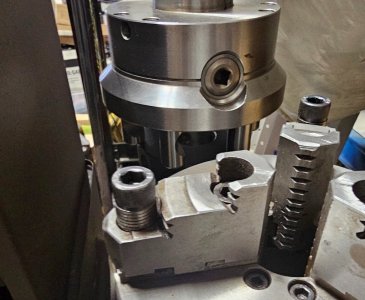

Peter, what you sketched is more or less what I have. The shoulder in the longer hole is slightly higher than the shorter one. The two holes in the bottom jaw appear to be identical. I tried a 25mm screw in the shorter hole and it fits fine bottoming out on the shoulder not the bottom of the hole. That makes sense because the difference in the shoulder height measures 4.9mm. That tells me that I can clean up the female threads with a bottoming tap and then use 30mm and 25mm screws to hold the jaws together.
I might also make tension buttons with longer screws like I use on my 3 jaw.
It is basically a set of sleeves that spac up the screw head so they can be used as expansion jaws when the jaws are set for OD clamping on a delicate part.
Some day, I'd also like to grind pillars to put on those 6 inside screws to act as chuck stops for squaring up stock held away from the chuck face. The screws are screaming at me to be used that way.

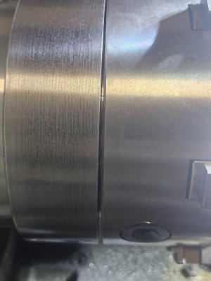

If you tested runout at a different diameter or a different temperature or a different clamping force, big changes can and do happen.
I wasn't really expecting miracles from SetTru anyway. It was just a musing based on the assumption that Vevor's runout was virtually guaranteed to suck. But this thing actually looks pretty darn good, so I'm gunna see what the chuck does without it first.

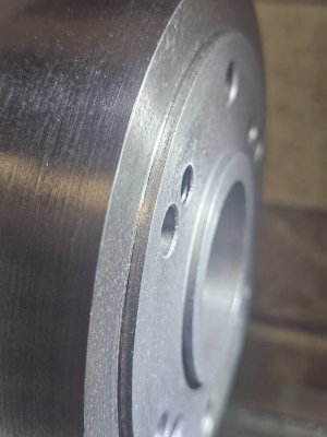

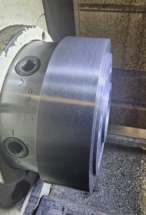

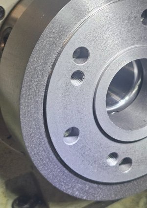

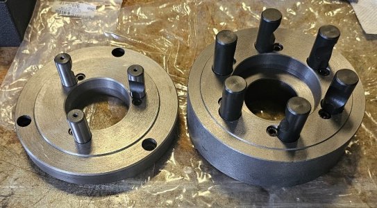

Backplate came. It is cast steel instead of cast iron. I'm ok with that but am wondering if this a really a good use of such a nice backplate. Need to clean the surface before cutting, but looks good so far. Hope the 4 pre-drilled mounting screw holes don't get in the way. Easy to check. But didn't do it yet.
