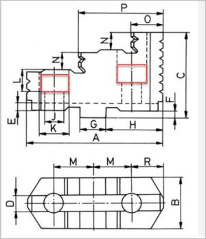

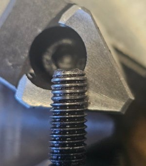

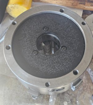

Peter, what you sketched is more or less what I have. The shoulder in the longer hole is slightly higher than the shorter one. The two holes in the bottom jaw appear to be identical. I tried a 25mm screw in the shorter hole and it fits fine bottoming out on the shoulder not the bottom of the hole. That makes sense because the difference in the shoulder height measures 4.9mm. That tells me that I can clean up the female threads with a bottoming tap and then use 30mm and 25mm screws to hold the jaws together.
I might also make tension buttons with longer screws like I use on my 3 jaw.
It is basically a set of sleeves that spac up the screw head so they can be used as expansion jaws when the jaws are set for OD clamping on a delicate part.
Some day, I'd also like to grind pillars to put on those 6 inside screws to act as chuck stops for squaring up stock held away from the chuck face. The screws are screaming at me to be used that way.

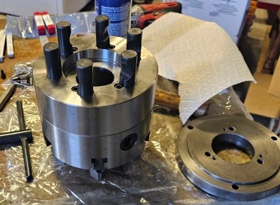

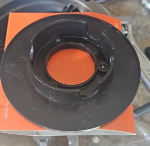

Backplate came. It is cast steel instead of cast iron. I'm ok with that but am wondering if this a really a good use of such a nice backplate. Need to clean the surface before cutting, but looks good so far. Hope the 4 pre-drilled mounting screw holes don't get in the way. Easy to check. But didn't do it yet.
I decided against using the cast steel backplate. I have a regular cast iron back plate that is thicker than a normal backplate. Since the cast steel is also thick, I decided to use the thick cast iron instead. It is all machined and ready to drill for the backplate screws.
Here it is with test fit with the chuck. Won't go on by hand but will with the screws pulling it in.
The chuck only has 3 screws in it. I will change that to 6. For now, it's time to spend time with my grandsons who are here for a long weekend.
For anyone who is interested, here is a visual comparison between the D1-4 and the D1-5 backplates. (4 on the left)
Another photo, turned to a tight fit. Just needs screw holes.
I will put a very small mark on it to indicate original indexing, but I will wait till I have the chuck mounted so I can dial it in by rotating the indexing before punching in the permanent index mark.
I'd guess where it is now will be best because the plate was turned at this location. But that assumes the chuck itself was built on its own center perfectly. While that might be true, it isn't guaranteed. Therefore, it is good to have a little wiggle room just in case. One way to get that wiggle room is to rotate the backplate on its own center. Quite frankly, I don't expect it to matter on my lathe because it's runout is so low as is, but I want to try it.
