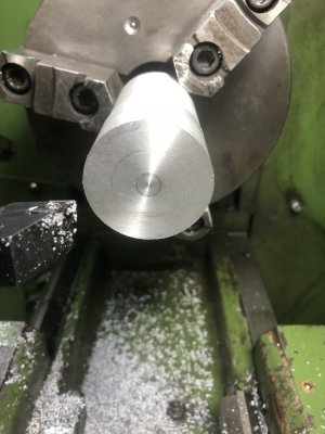

finally bit the bullet and bought a lathe today. It's a C6236 Force International (ie HoT fame). Price wasn't bad.. Didn't think the truck was going to work though.. Came with some tooling. though, there is no steady rest or follow rest.. I'll have to keep an eye on fleabay to see if something comes up.

looks like I have a bit of a lemon. Feeds work well. No problems with it. Screw cutting will be an issue. As it feeds, you can see the handle pause slightly every time around. You can also feel something wanting to tick the handle. I'll try and upload a video later to show what I mean.. I'm also missing the 3 change gears I would need todo some threads. I just know it should have come with 3 gears and I got none. Looks like a 40, 45 and a 50T gear. Anyone know if Grizzly ever had a GH1440 model lathe? Pretty sure the G0709 or G4002 won't work for parts. I have sent a request to Warco and another to a chinese dealer asking about parts. We'll see what they say
I'll wait for the vid, but what handle? You mean the lever that engages the threading clamshell onto the threading lead screw?
Your lathe is likely different than my 14x40 but I would check
- The threading lead screw. Are there damaged threads it keeps tripping on every rotation? Is the lead screw rotating freely without power or does it wobble (ie. bent slightly)
- Condition of the clam shells (mine requires apron removal to examine). If internal threads were nicked or badly worn or out of alignment or embedded chips... anything that is preventing them from engaging lead screw properly. Careful here with clamshell dissassembly, they very likely have a top/bot orientation & probably fastener to secure.
- Clamshell action. Check when you engage the threading lever, if it net lowers or raises the leadscrew as opposed clamping equally, it may be out of adjustment or something is amiss.
- Headstock gear train. Here I'm working off memory of which gears are driving vs. idling but if you put it into threading mode (as opposed to power feed mode which should be locked out) does the leadscrew turn nicely? Do you hear or feel gear noise corresponding to the skip cycles? Maybe the threading gears themselves, tooth condition, improper mesh allowance...
- You hopefully have a shear pin between leadscrew end & headstock engagement. Mine had a steel rollpin vs, brass or something to break more easily under torque which I only discovered. Anyway, if a pin end is protruding or scraping inside the cover/cup it may be causing intermittent friction.
- Leadscrew end bearings or bushings. If they are giving up or partially seizing it would be another source of intermittent friction that is picked up in your threading while engaged.
Good luck, tell us how it works out.
The lead screw had some crud embedded which I used a wirebrush to remove. it now looks pristine. One of the first things I checked was for any wobble while the leadscrew was under power and it seems to be fine. One thing I noticed was that when the clam shell engages, the threading indicator quits as the leadscrew is actually pushed out of the way of the gear on the threading indicator. I was looking at your photo's PeterT on your rebuild, How much do I need to remove in order to get at the clamshell? it looks like a few bolts and the gearbox would come off. But I also assume I would need to remove the lead screw since it will be attached to the half nut.
From the vid it looks like you may have excessive backlash in the carriage hand wheel mechanism.
If you move the hand wheel, does the carriage move right away, or is there quite a bit of backlash to take up before it starts to move? Go from FWD to BWD.
Also, check the rack and the pinion gear engaging it for chips or other contamination.
As PeterT and Dabbler suggested, it probably would not hurt to rebuild your apron. A bad key / keyway in an internal gear shaft would look like that as well.
+1 to everything RobinHood said.
One more question: when you move the carriage by the hand wheel is there any binding/friction that is intermittent?
If I interpret correct, that tells me the half nut engagement is displacing the leadscrew into the lathe because the indicator gear wheel is fixed in position on the apron. (The indicator assembly on mine is adjustable to swing completely free of the lead screw threads free or adjust tooth engagement. So unless it is just barely contacting to begin with, does it look like the clamshell action is bowing the leadscrew? It doesn't matter if its pushing it up/down or in/out, the issue is alignment. Either are not good.

no friction that I could tell or binding at all. hand wheel turns freely. I think I might have found the issue though. there is a gib adjustment block which I believe was much too loose. The dovetail was actually flopping around until I tightened up the gib slightly. Now I need to figure out how to adjust the half nut position so it's not bending the leadscrew ever so slightly.
