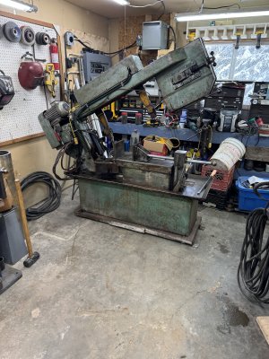

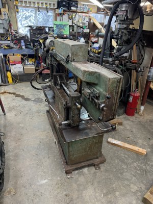

Progress! In the shop, off the pallet and onto the floor. A little shuffling and it’ll be into place soon!
And it’s in place. 1600 pounds of saw.
It’s amazing what some pry bars, ratchet straps, and taking some weight at one end with a cherry picker can do.
I do see another section of built in work bench getting some modifications in the near future though.

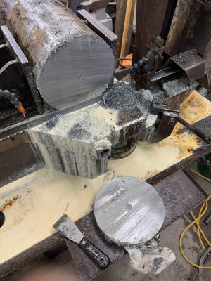

I've used various metal band saws over the last 40 years in different shops and mills. . The soluble oil, which the Brits call milk ,chuckle, is used both as a lube and flush. You want to flush the swarf out of the tooth gullets . As a lube it's in pretty weak concentration , compared to what your lathe or mill takes. Of course the guides need to be well adjusted. But the hydraulic down feed is what makes these saws. Too fast and the blade wanders to the far corner of your shop, too slow and all you do is dull teeth.

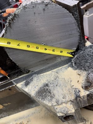

So I wrestled a piece of roughly 8 1/4” mystery alloy (suspect 4140 or similar ‘tough’ steel into the saw tonight. With a light feed, it still cut through it in 18 minutes. Considering I have almost 20’ of this stuff and uses for steel this size, and the saw doesn’t struggle with it at all, I’m happy. Just need to figure a better method for loading this big stuff into the saw…..

I make a lot of fixtures and such for the field machining that I do for work. It just so happens that most of them are about this size. Until now, We’ve been getting them cut from plate, but now this is an option between the saw and free material. (Yes, I get these ‘pins’ for free, they are scrap parts from work.)
The first couple slices will get holes bored out to 2 1/4”, then sliced in half. Some other little tweaks, and they’ll become jigs for setting up the line boring bars on shovel side frames.
