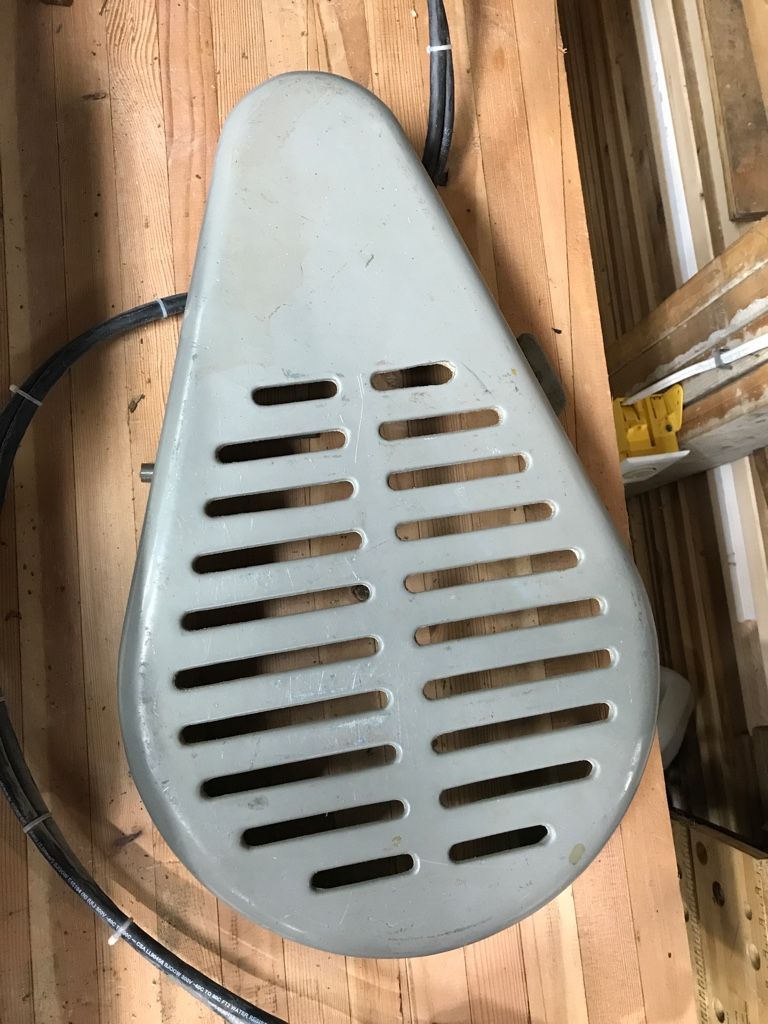

What's this thing?

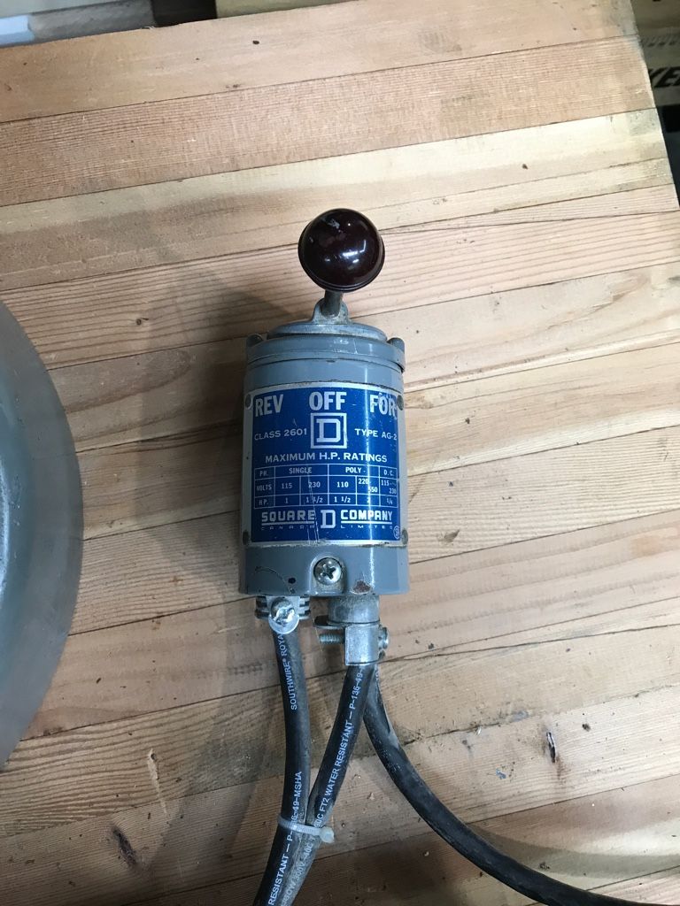

I have this very same switch on my SM. What do you think it's good for considering both machines have threaded spindles?
Well in a threading operation where the carriage needs to be returned to the start it would be handy.
I think more handy than using the reverse gears.
But I’m no expert.
Edit: on further reflection it doesn’t make sense when threading because when the tool hits the gutter you release the half nuts, withdraw the cross-slide and hand wheel the carriage back.
So really good question that I have no answer for.
In using Bert's SB lathe over the years, the switch is more than adequate. No problem with the threaded on chucks. His switch was nearly identical. - I repaired it 3 times over those years and it was still going strong. Probably 1000 hors of use and tens of thousands of on/off cycles.
Actually lots of usable situations with that reversing switch on a threaded headstock...Opposite side cuts using Collets/draw bar set-ups as well as with between centers with a dogleg drive.
Seems to me, any operation attempted in reverse will tend to cause the chuck or drive plate to unscrew from the spindle. Or am I missing something here?
Cutting in reverse on a threaded spindle with a chuck threaded on is dangerous, even a slow speeds. Please to not tempt fate.
You can use collets, because they don't rely on threads to hold the chuck on.
The reverse can used in polishing/filing , even with a threaded chuck, as the loads on the work piece are tiny.
