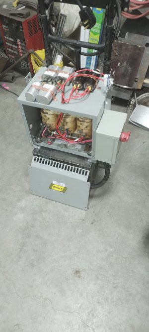

Me and my buddy made one to run my milling machine it's 5hp 550v pretty easy things to build basically just motor strapped too transformer. Used a 7.5hp motor and 10kva transformer and it can start the mill on lowest rpm highest load configuration.
More or less built it same way this fellow on YouTube layed out. I found his way of explaining things easy to understand so if you don't already have a plan or don't just plan on belt starting your RPC. This may come in handy for you.
Only picture I seem to have of my RPC before I built covers for the caps. I used a light switch to kick the idler on untill a proper momentary switch showed up.
