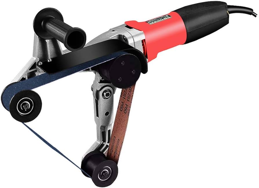

As a welder who uses grinder more then he likes to admit, I don't see a point in it your stuck with buying PFERD discs which are good quality but expensive without the fancy system.
Your better off long term with multiple grinders (I own 6 lol) and for polishing and hand rail stuff want hand held belt sander
It's a neat idea but for hobby seems over kill and for shop environment probly cost to much in long term then just buying and setting up grinder work station for each task.
Also I watched the promo video on it were guy polished the 90° I recommend not grinding handrail like him lol. If you want it to look seamless lay grinder on the flat and remove weld. Don't use the tip you end up with a wavey finish which isn't good for polished product lol
