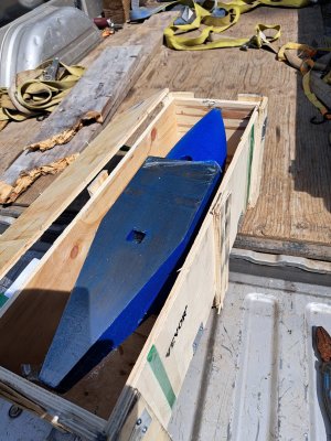

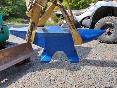

NEED ANVIL?
And do you need to face it? I've been using mine for a few months and the surface is fine.
Can you still face it if the anvil is cast though?
A guy would need a helluva heat source to warm it up enough no?
These are cast steel - does not seem to need to be faced and does not chip easily.

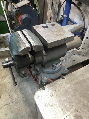

Sorry for the late entry to this thread - I’d missed it.
(The purpose of the anvil project, from before covid, was to try out a new plasma cutter.)
I don’t often need an anvil so my small home made version is good enough and doesn’t suck up a lot of space.

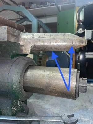

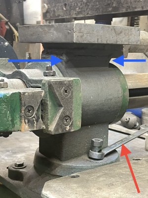

Originally the top of the vise had a 3 x4” flat section (blue arrows, pic below). Welded onto the flat section is stacked 5/8 x 3” flat bar. The vise can easily be rotated 180 degrees by using the 3/4” nuts that are welded to the swivel locks (the 3/4” wrench resides there).
Plasma cut marks can be seen on the horn:
The thickness was adjusted so that it is level with the top of the vise jaws (3 pieces of the 5/8” bar + a spacer). Dropping a steel ball from 12” gets about a 2 1/2” rebound, a bit disappointing but ok. The vise is grounded to the adjacent fab table.
