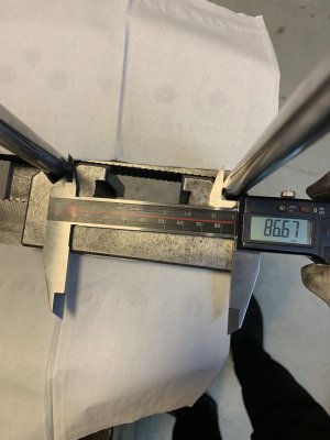

99.70mm divided by 25.4 mm/ inch = 3.92519 inches. It does not make sense in imperial either. Did you guys measure the tool holder or the tool post?
I remeasured it 3 hours ago and confirmed that the distance was 99.70mm, which made it very strange. Does it distinguish between the Asian and American versions?QQ图片20230309192911.jpgQQ图片20230309192921.jpg
86.67+112.69=199.36mm/2=99.68mm,So 99.70 is an accurate number, we are all confused, I hope the friends who have this tool holder to measure it, so that an accurate and correct number can be retained!

@a smile , you obviously measured correctly - I was not doubting your measurement.
You did the right thing: make your tool holders to fit your tool post exactly. So well done.
Possibly it is the Swiss made their tool post slightly different so that one has to buy THEIR tool holders as nothing else will fit (unless you make your own).

@a smile Nicely done - never did I doubt you either. I just remeasured my holders and got 100.00mm between the centres of the veeways. I may well be just differences in manufacture and standards as all the 'real' Dickson tool posts re in even imperial units...

Mine is a Rapide model. I measured the width across 2 1/2" dowel pins - they are +/- .0005. After subtracting the pin width it was 100.00 mm. But now that you have mentioned it, I will recheck it again to be 100% sure.

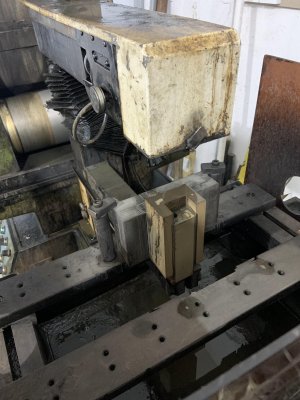

Using EDM allows me to be laid-back, it gives me time to do other work while working slowly

Sun - How long does it take the EDM to make one of those cuts? Cool parts for sure.
Now I can finish the processing in about 15 hours, but sometimes the EDM will have some strange faults, resulting in me wasting time and increasing the waste of molybdenum wire, sometimes it may take more than 20 hours.
The combination of a beat-up EDM and a completely novice operator is a bad collaboration!
Perhaps for a skilled operator + a qualified equipment, the estimated normal processing time should be about 10 hours, or less!
I am getting familiar with the operation and also repairing the EDM. After the test works properly, I will make several products and sell it as commodities!

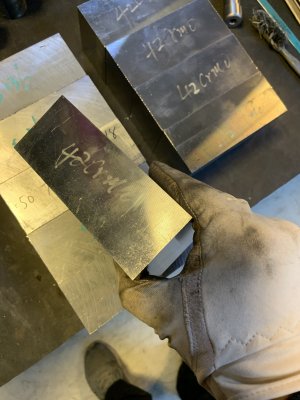

Today, I finally finished the production of another 10 knife holders, and I stacked all the knife holders together, and there were 40.
Five of them are V-slots with a pitch of 100mm, which is not the model I use, so I will publish them to sell in my Amazon store.
