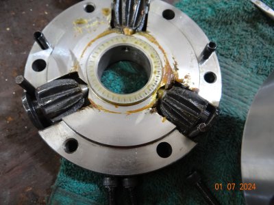

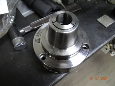

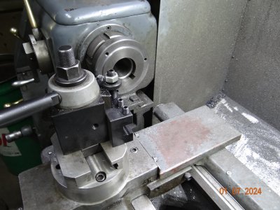

Well, I did it. I solved the problem. I bought a new backing plate and collet chuck for $222 Cdn from Bostar Precision Tools on Ebay
The backing plate had to have a skim taken off for final fit. Out of the box runout was .001 on the face and the register have to have .100 taken off.
I disassembled it to check for chips and gunk and it was really clean inside. After completing the install a test bar put in the nose read .00005 runout so I am good with it.
