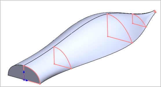

I took a crack at a rudimentary nib just to show some initial workflow to get you going. Real nibs can have some interesting & complex details depending on the type. Surface modelling is a skill unto itself. There are many pathways to get to the end result (highly dependant on the software), but some paths/techniques are better than others.

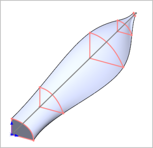

I made a top view of shape because that is a predominant feature. Connect the spline control points to center because these will serve double duty as planes. Mirror the profile to give me eyeball shape. If I had a good top view image it would underly this sketch for better reference
Made a series of cross sections at these planes. Here is where you can excercise control. The curve is a 2-point spline so I can shape it. The X-line segment is converted from reference sketch. The Y segment is whatever I make it. Also I specify the spline is perpendicular to Y-segment. Notice I only work on half the nib, because I intend to mirror. Then the sections are lofted & again you have control options. I use the top view spline as a control curve so the surface will be coincident to it. Then mirror the body about the center plane. Check surface quality with zebra stripes or other curvature tools

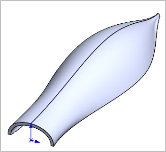

Then I used a shell command. Input wall thickness & removal planes & you get this.

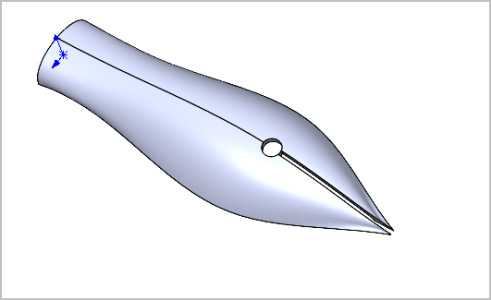

This simple model has a flat bottom just to demo the workflow but when you look at most nibs they are more enclosed on the handle end so you need to reflect these details in the sections. Sometimes adding is easier than subtracting, all depends on the model & where you can best control

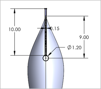

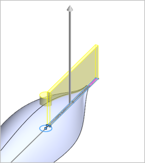

make the slit feature.... and on & on
That's a very different method than I was thinking - but you've also made the shape more complex! I should really hammer one flat to get accurate measurements
