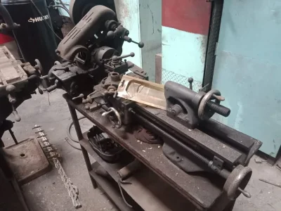

can anyone tell me anything about the configuration of the second machine it seems to have the same size lead screw but has the quick change gearbox in addition to an additional lever up near the belt tensioning lever which I suspect is some sorta clutch, the top tensioning bracket has also been broken this lathe was dropped when they were moving it, its still at the machine shop so I don't know the serial number just yet.

That is indeed a clutch assembly on that second lathe. The manual has some decent exploded views for clutch and non-clutch versions, as well as the gearbox and non-gearbox lathes. That second lathe also has a hand wheel on the end of the lead screw that can be used to manually turn the screw and give you finer carriage control.

thanks I would have completely missed that, honestly I was looking what i could salvage off this machine for the other one since I cleaned it up and it cleaned up REALLY well(dont have pics yet and i need to upload that other post), bed isn't worn at all but the hand wheel bushings worn all the way though the machine is a victim of grease. but the more I was looking at the photos the more I realized how nicely configured it was overall, additionally it the machine shop owner said they do have the metal cabinet that came with it still so ill get that when I decide to move it

no i own them both, but the one without the gearbox is closer to being started than the one with the gearbox, the one with the gearbox was dropped and the tensioner bracket was broken so that will either have to be replaced or welded so the plan was to fix them both back up in the long run. In the mean time i would use parts off of the gearbox lathe to get the other one in running condition then i could build up the parts for the gearbox one (restoration) then when that one is complete i could pull the other one down for restoration because right now i just cleaned it up.
