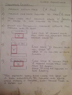

I have been thinking about this post for a long time and I am finally ready to chime in. Took me about a month to find this sheet of paper lol. This is the system I use and it helps to compensate for a few variables. Credit goes to the guy on the top right. Try it!image.jpg
