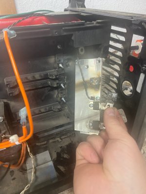

Update: There is indeed a problem with this welder.
It only takes effect at higher voltage settings, above 6.5.
The drive motor will slow down. Through research and conversations with Miller and our local welder service center, I've determined it is likely the output rectifier diodes/one diode. The diode is likely half cooked, can't maintain the necessary current, and the voltage sensing of the welder automatically slows down the wire feed.
I've priced out the whole output rectifier from miller at 200$ cad shipped to my door.
Before I pull the trigger on that, I'm disassembling the machine all the way and seeing if I can get a part number off of the diode's and order off of Digikey for likely 1/10th the cost of the miller parts.
I'll post when I get something figured out.

I called Kristian. They were the ones that gave me the 200$ ish shipped to me quote. I've fixed welders before and I've never seen a Miller Genuine Replacement Part (TM) be cheaper then an electronic component ordered from an electronics supplier. Usually Miller is charging 5-10x the cost you can buy on Digikey/Mouser etc.... IF they have the component and not a whole giant assembly.
If you can get to the damaged component, and the diode looks heated, replace them all, of course. If one has partially failed, they were all stressed. It is a very cheap experiment, even if it points somewhere else ultimately.
I mentioned Kristian, because they are very skilled and helpful. I trust them, and that is not easily won from me.
@Dabbler They seem good to deal with. They also said that the likely culprit was the output rectifier. Both them and Miller Tech came to the same conclusion.

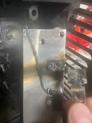

@combustable herbage It is not configured as a bridge rectifier. The "output rectifier" consists of three individual power diodes. Two diodes rectifying the inverter output, one as a freewheeling diode for the negative alternation. The problem is that the diode(s) are only half bad. AND they only have issues under heavy current/voltage. I would have to rig up one heck of a test rig to simulate those circumstances. It could be one of the two rectifier diodes increasing voltage drop under high current, or the freewheeling diode leaking back in reverse...... If they are inexpensive enough components, I will just replace them all. I don't have 100a DC testing capability.....
Well here we go fellas.
Pretty sure this here is the culprit……
Now let’s get some digikey action for some new diodes happening and before you know it I’ll be welding!

Update: the parts arrived last night. I also decided to order some conductive thermal paste, as the diodes were mounted on the heat sink, and the heat sink was also the positive bus. I only had non conductive handy, the only place I could find conductive paste was Amazon for 72$ for a tube! (Ouch)
But I thought whatever, I’ll be in this welder for about 390$ said and done, so I might as well do it right.
I got the welder reassembled with all new diodes, and it works like a charm.
I can go full WFS on higher volts, and the welds look fine.
This saga is complete.
