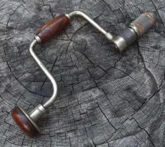

I’ve even gone so far as to ditch the cordless drills and other than the bench mill @ drill press my workbench has two other devices for making and cleaning up holes - a nice corded Milwaukee 1/2” drill, and a old-school Stanley brace & bit modified with a keyless three-jaw chuck. The brace is faster than the Milwaukee for most drilling operations in light-gauge stuff, and does a way better job countersinking or cleaning up holes. Also works great with step drills, never goes too deep.

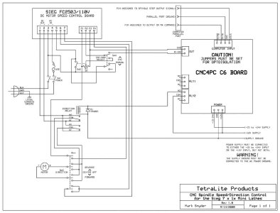

and more research. the design of my BB CT129 or the equivalent Grizzly G0704 mill uses a motor control board very similar to the ones used on the Chinese 7xXX mini lathes. all of these can have speed control done by an external 0-7 or 0-10 VDC signal. which means my design should also work other machines with only a bit of software changes. starting testing later this week, as long as SWMBO doesn't object to me spending the next week hunkered down in the shop

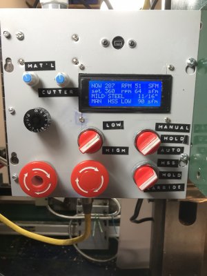

Almost there. Controller electronics & mechanical has been completed and installed on mill. Still need to complete software, stuff to be done:
> update Arduino code to operate under automatic control
> update code to react properly to changing from low to high speed using the mechanical gears
> set scale factors in the code so the control dial setting matches the actual spindle RPM
> pretty up the front panel and get rid of the Demo labels.
> make up nicer knobs
LCD display:
Top line - actual RPM, actual SFM based on selected cutter size and actual RPM
Second line - dialled in RPM, calculated SFM based on speed dial, cutter material, and cutter diameter
Third line - workpiece material, cutter diameter
Fourth line - shows settings of switches
Top left-hand grey knob selects workpiece material
Top right-hand grey knob selects cutter diameter
Black knob adjusts motor RPM under <manual> control
Two big red button - left hand is master power, middle button is Hold override. Hold override stops everything but leaves the LCD display at the last configuration.
Middle switch changes scales to match actual mill gear setting
Top left-hand switch selects <Manual><Hold><Auto> spindle RPM control. <Manual> reads the black dial and adjusts mill RPM, <Auto> sets mill RPM from the workpiece, cutter diameter, and cutter material
Bottom left-hand switch selects <HSS><Hold><Carbide> cutter material, and is used to calculate best SFM from a look-up table and cutter diameter
Putting either of the right-hand switches to Hold also stops the spindle, and changes the LCD display to match desired settings.
the KBIC-120 control board has been adjusted to nice slow ramp to full speed, I might tweak it a bit to speed up the ramp.
