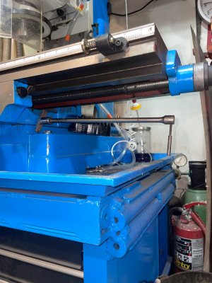

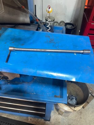

I should follow the KISS rule more frequently - but I confess i often build something that takes hours and only occasionally saves a few seconds. So i get why you’re thinking about auto gibb locks. Makes way more sense than many of my projects.
My Z axis gibb locks are on the right side of the mill (RF45 clone) but the raise/lower hand wheel is on the left side. What st##pd engineer design that! (see note below).
My Y axis gibb locking handle not only conflicted with the table (if the Y gibb lock handle is vertical up then it conflicts with the table during X travel) but it is also hard to reach or even see. In photos below - this time I had a simple/quick solution - I attached a socket extension. So maybe @GKShop consider a project to improve gibb lock access and visibility.
(Note: I am an engineer and I don’t mind pocking fun at some fellow engineers that don’t have a practical bone in their body)
