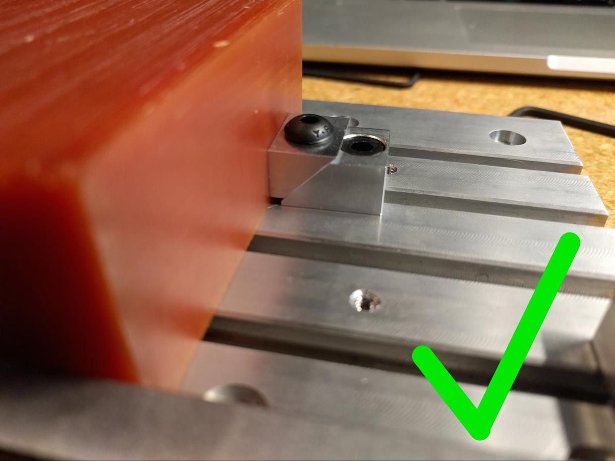

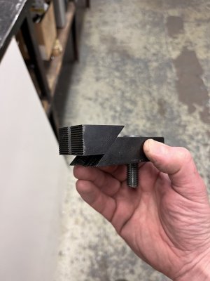

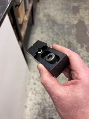

They sure look handy.
Looks like they call them edge/side/wedge clamps.
Perhaps Aliexpress has them?
I think what I like most about them is that they don't suffer from the same T-slot tear-out potential than many other clamps do.

Presumably this type of clamp works by making a slip critical connection between the 'base' and the table via t nut - that's a connection tighter than the friction angle - and then using the screws to force the sliding blocks into the work. Those blocks clamp low down on the material - hence the 'toe' designation?
