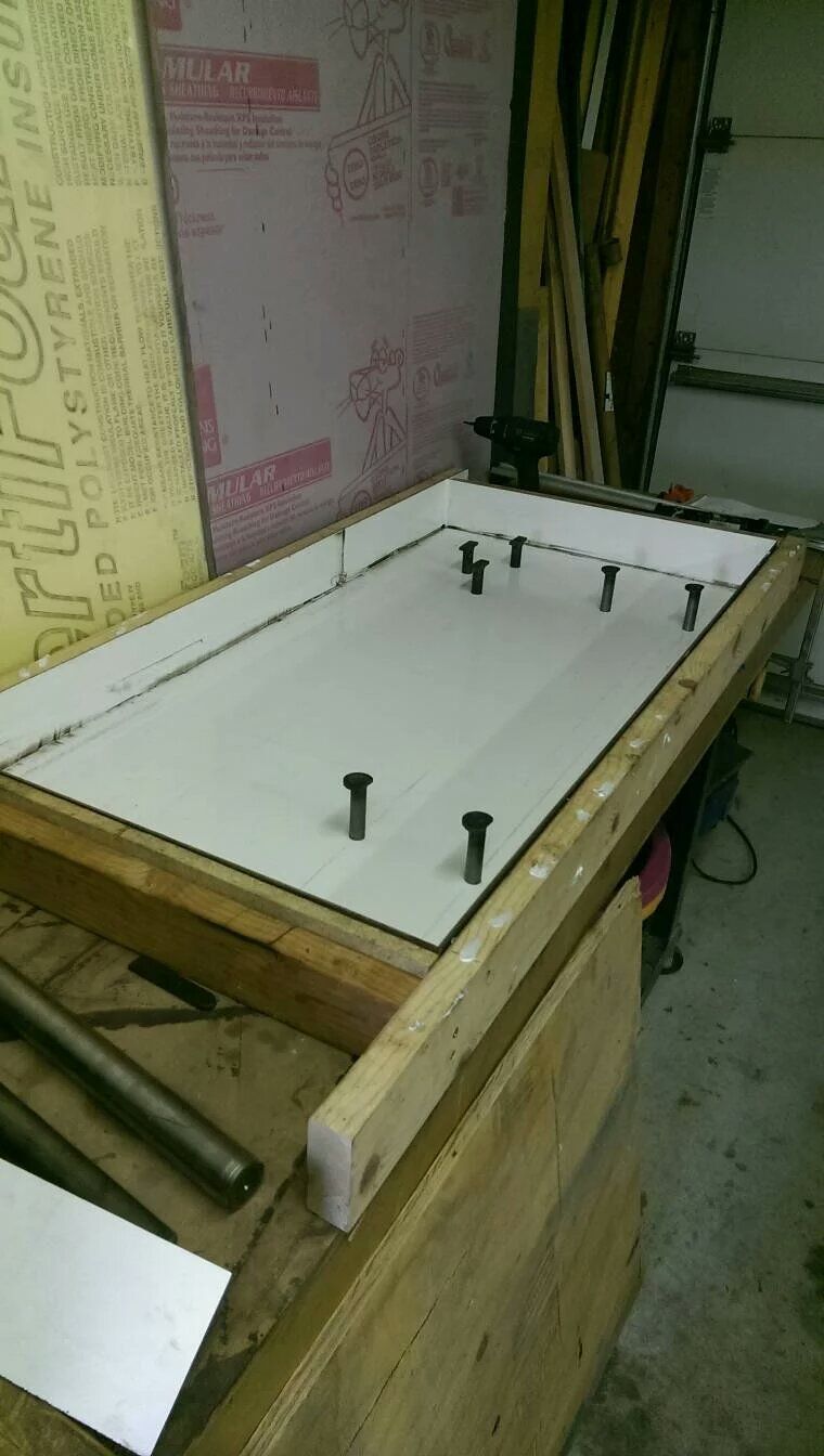

Concrete would be amazing. You could also use something like a welding table and secure it to that. Any size plate would do but I would personally look for some 1/4" plate or bigger for a table top. Busy bee in calgary had a lathe stand on clearance in there show room for $175 that would also work.
Do you mean you can purchase a slab like a countertop material? or you would pour it yourself into a like a barrier dam integrated to your bench table?
Either/or concrete would seem an interesting option being both solid & vibration dampening. I know little about drilling holes like for your mounting lug holes.
Funny I was just thinking about the same thing for a different purpose. Make up some steel strips from C-section with threaded holes/nuts that matched the mounting lug pattern on a bench machine, then basically cast it in place with cement. I've read about guys using epoxy/aggregate mixture (as opposed to water type regular cement) on home brew CNC frames & they report excellent stability.

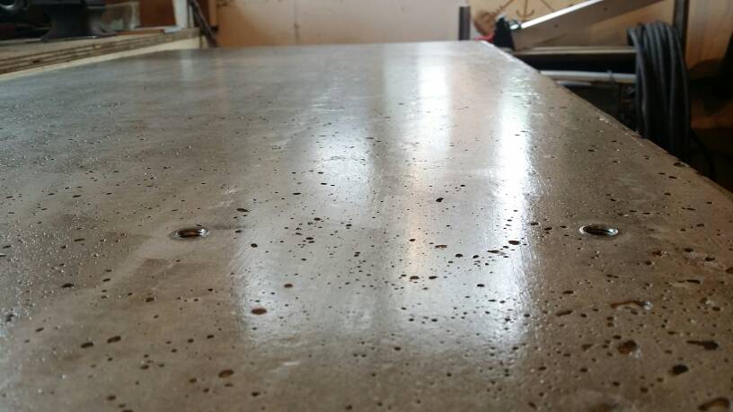

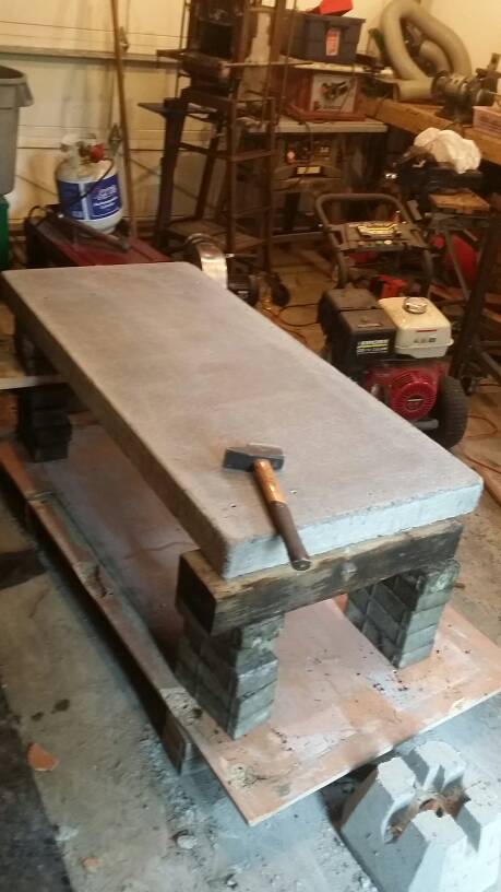

I would pour it on melamine with some inserts matching the bolt pattern like this guy did below. He says on the last page that it worked perfectly. He even has the whole thing on wheels. He also has some threaded bolts on the bottom to level the whole thing.

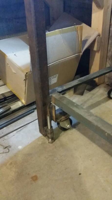

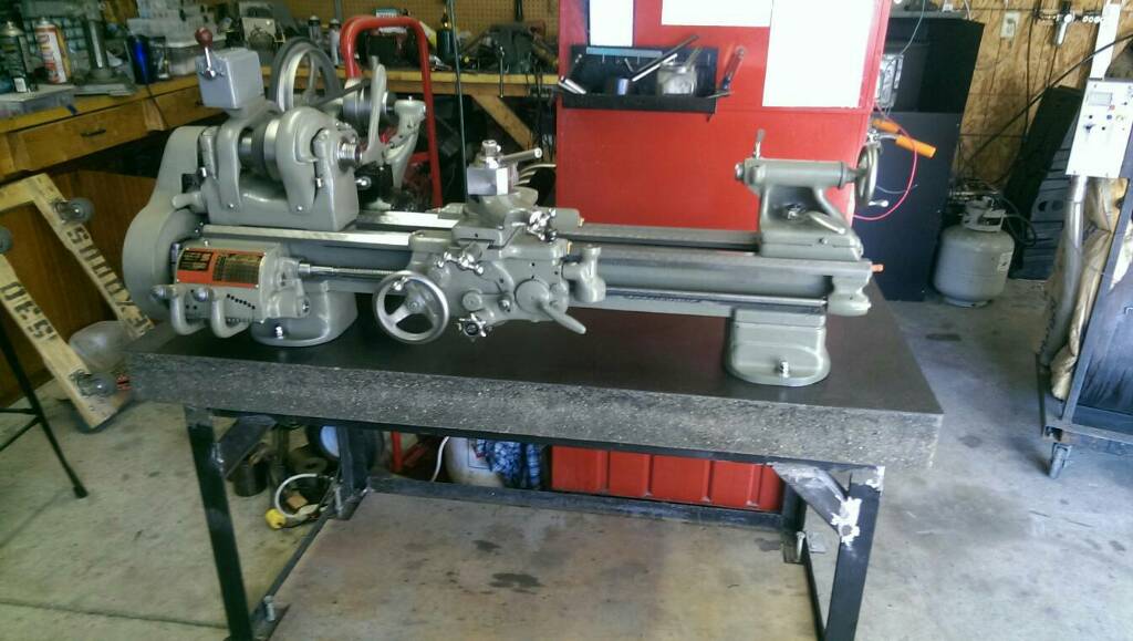

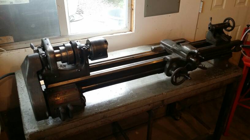

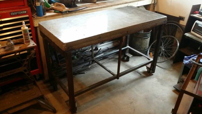

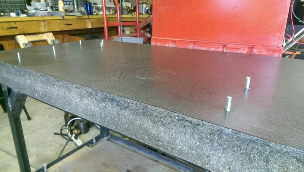

I ended up making the table out of concrete as it was all I could afford. All the metal I found in the back alley around my house (Including a 12'-2x2x1/4 tube) I lifted the 450lb cement slab myself using some sort of neolithic block moving techniques. The table can be leveled with those thick bolts in the legs. The casters were the most expensive part and they are rated at 1000lb each. I ended up spending about $250 on everything. I placed the lathe to seen how it would look but I still need to clean it up a bit. Does anyone have advice on cleaning a SB?

Your bench top looks great.
