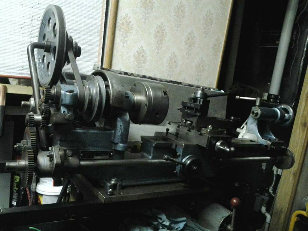

I found this lathe for sale. It's a Ml4 myford type. He wants $2000 for it. I haven't been able to find out if that is a decent price for it. I assume if it is in good working order it is not too far off the price mark than similar machines I've seen for sale in the UK. I am going to see it tomorrow so I'm not sure of its condition. Any thoughts or advice before I head out to see it?

Myfords were very popular back in the day with model engineering types especially in the UK. Maybe the 60's & 70's was the golden era although I think predominantly those were ML7's. Not sure what the age ML4 is but guessing 50's? This might help http://www.lathes.co.uk/myford/index.html
The issue is they are few & far between. I've read comments by older gen ME's in UK who say they just cant be bothered anymore because parts are getting scarce & that's ML7's & 10's. They just go straight to Asian machines & put their tinker time in those. If part of the your buzz is the nostalgia of the machine & you are committed to some TLC or even ground up restoration like some nice examples on this forum, that's a different angle. Type 'myford' into ebay & see how many hits you get. And of those, I suspect majority are model 7+. If you are wanting to get into machining & make parts right away, personally I'd invest in something newer myself.

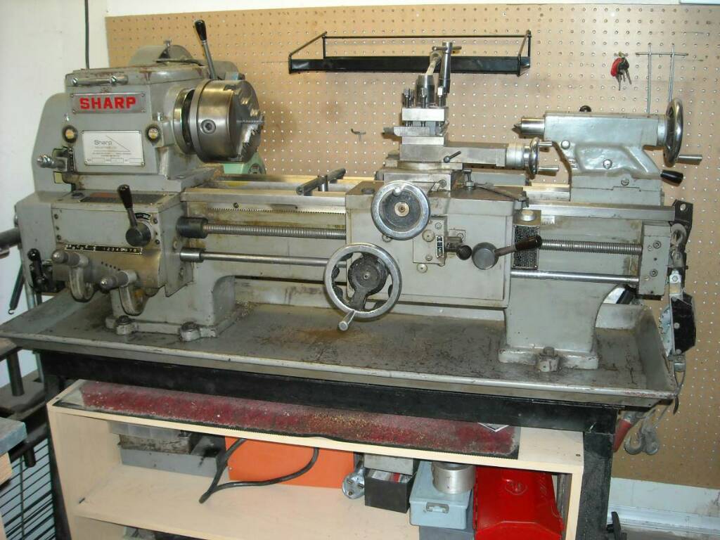

I will check out the basementshopguy. I've been looking for about 5 months the smaller lathes seem to be 2000+. I do like the idea of fixing up and using an antique machine, though a southbend would be easier to source as you have said. I found one in Bellingham but it is $2000 USD. This myford is right by my work, along with this sharp lathe which is also $2000

The Sharp also has a quick change gear box. Really there's no contest unless the Sharp is broken somehow.
It's a Sharp Lam350B from Taiwan. There seem to be decent reviews of it online. I'll see if I can have a look at it next week.
