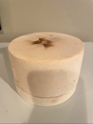

Why? There are lots of dangers in handling molten metals of course, but as far as I can see, the increased risk with this is mainly around having molten metal inside a plastic cavity. It could lead a fire with noxious fumes. Not that that isn't serious, but its not a RF issue. It's also mitigated by the extremely high temps silicon carbide can handle and that the heated bit is inside a ceramic cocoon. There is also danger in the dust from various materials that shouldn't ignored but is easy to protect against.
I've been reading a bit on this, and apparently no metal in the microwave is a bit of myth. What you can't have is metal by itself
(no where for the energy to get absorbed so its starts arcing to the inside of the oven) or that is a shape that could arc (thin sections, pieces close together like tines on a fork). Even then danger is damaging the inside of the microwave from arcing, not rendering an unexpected new crater in your neighbourhood. The metal largely reflects the microwaves which doesn't matter if there is a bowl of soup (or silicon carbide crucible) present to absorb them and the silicone carbide is high absorptive of microwaves.

Silicon carbide grit is available from any lapidary supplier. The grit size matters (not too coarse, not too fine) and I have acquired a 5lb bag of 150/220 grit which is perfect. It is known as Stage 2 grit if you're looking.
Harder to source in any quantity is the sodium silicate (water glass). I picked up a 4oz (100ml) bottle from Amazoom for $25 or so. However this stuff is hard to find unless you are associated with a school somewhere. Several Canadian suppliers have sodium silicate but they will only sell to an edu institution. Cost is about $20 per litre.

I made my own waterglass with kitty litter stuff ( silica gel ) and sodium hydroxide.

He is only casting 3D printed items like benchies etc and I think that there is a serious limitation because his temps are too low to allow any serious pours. The metal cools too quickly.
Far better to go the whole hog decent sized foundry and waste oil burner with pressurized air supply. That is the route we are gearing up for with my brother and my friend.
