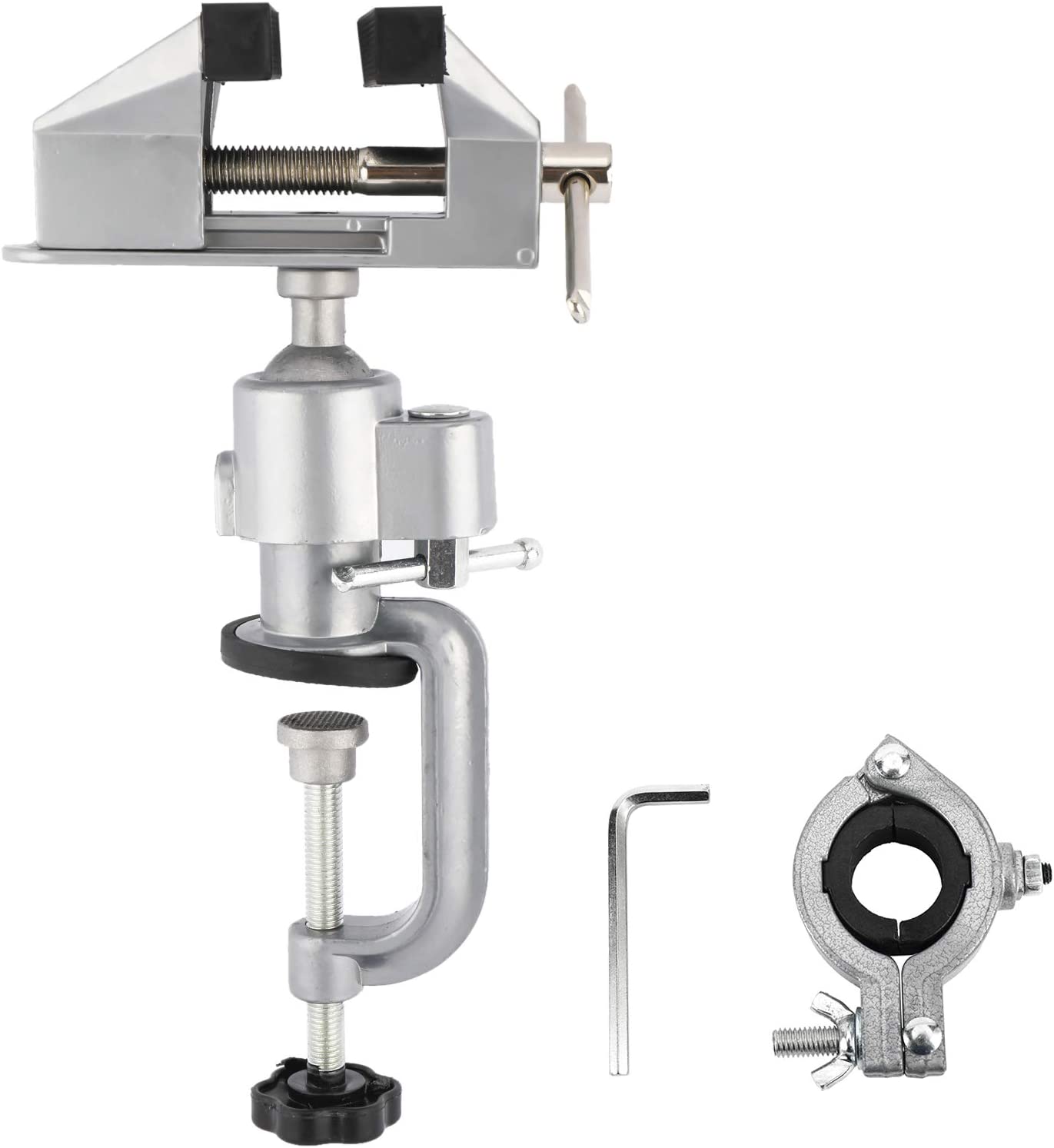

Just throwing it out there. How about using a small angle vise as a mike stand?
That was my first thought too - Good secondary use for a Panavise or similar small swivel head vise.
