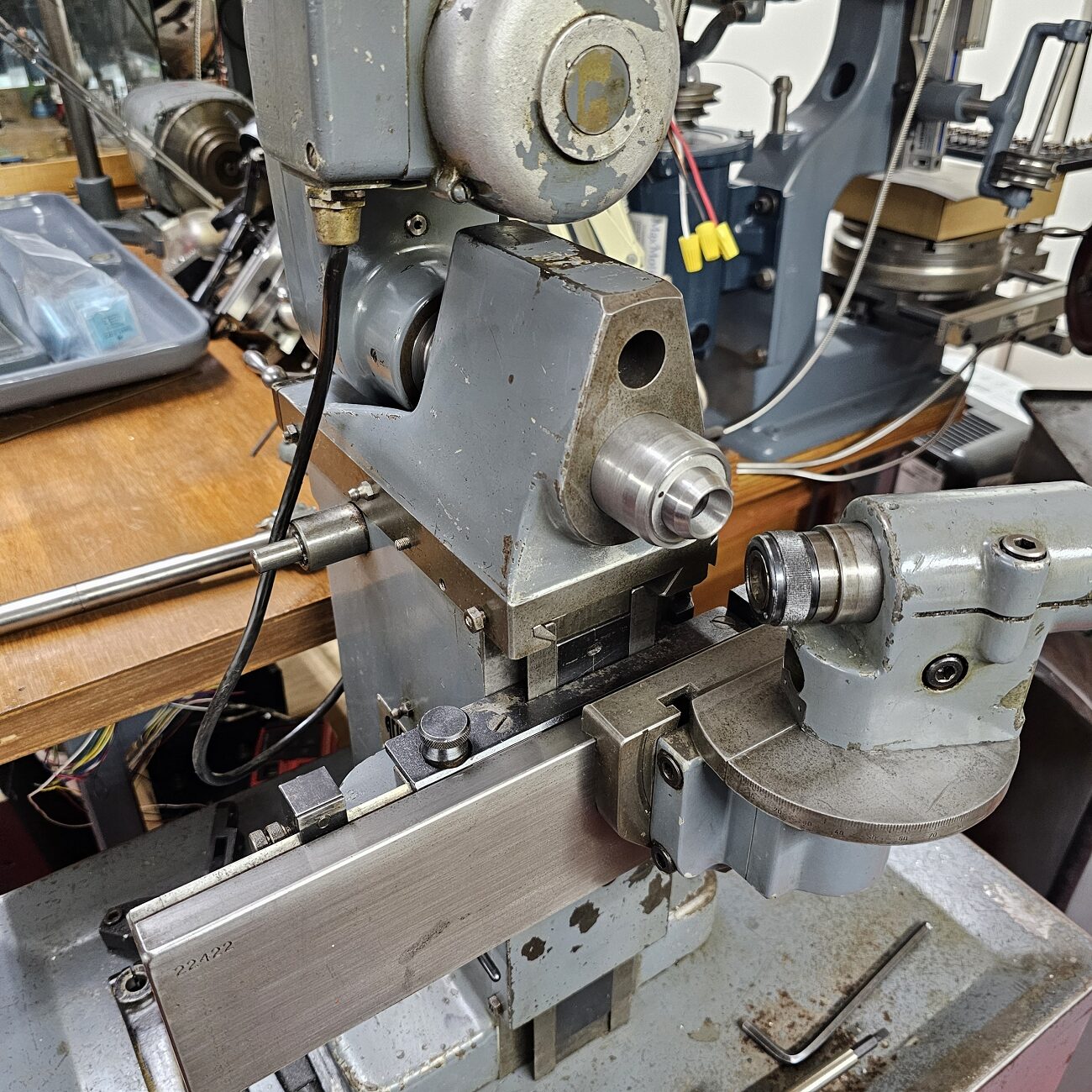

I didn't really realize how small these mills were until some of your photos showing the sense of scale.
