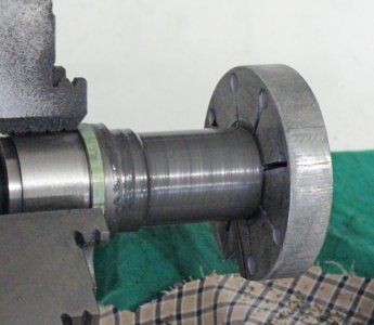

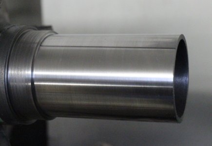

The fit into the machine tool is so finicky I elected to lap the final OD. The housing passes through the bore shown in the first photo and gets clamp by a bolt that slight distorts the cast iron. The original was pefect to a lot better than a tenth over its length and I wanted the same. With lapping I can creep up on it and concentrate the lapping to tight spots. With fine compound, an area what is a 10th off is readily apparent.
Making a lap (test fitting with the original housing
constant checking with an indicating mic until its perfect. The mic is set with a gauge block and essentially used as a snap gauge
again, a little bit out of sequence, but the fit of the large section is really important. The motor and twp speed gearbox relies on this fit alone, the two are held together just by the fit and two 60 degree pointed screws. The house is a very close sliding fit, it can be taken on and off by hand but is tight enough it would fall out (there is nothing but the fit holding it in place)

And this is the housing done! Next up, the spindle shaft.

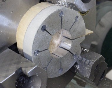

Side question on the aluminum lap. I've done this myself but found the clamp bolt to be very sensitive especially with a new lap charge. Even with fine threads. Subsequently I saw Renzetti's method where he enters the lap bore with band saw, making the clamp slit. But then he makes shallow radial infeed cuts around the ID before backing out the blade. Did you do this? It definitely made the forth & back action a bit smoother somehow, so I'm guessing the compound has a place to go, or maybe its churning & recycling compound a bit within the channel? The other mod I made which I think was probably stolen from a commercial lap is somehow marry a wrench to the clamp screw itself so you can adjust the squeeze on the fly while the machine is still turning vs stop & start.
For my radial liner OD's I made a lap as shown. The idea was to combine the slits with end relief holes so that hopefully? it closes down more radially like a collet principle. In my minds eye I think a single clamp bolt on a split cylinder is basically distorting it something like a clam shell 'C' action if that makes sense. But the question is, does it really matter? I wish I knew someone with ANSYS haha. Laps are consumable items anyways although they can always be re-dressed to be re-used for larger dimensions. My experiment worked but I'm not sure any better than a simple lap.

Thanks Peter. On the lap, I was aware of the style RR uses. Probably works better, Rob is a smart cookie, just but the way I did it worked fine.
